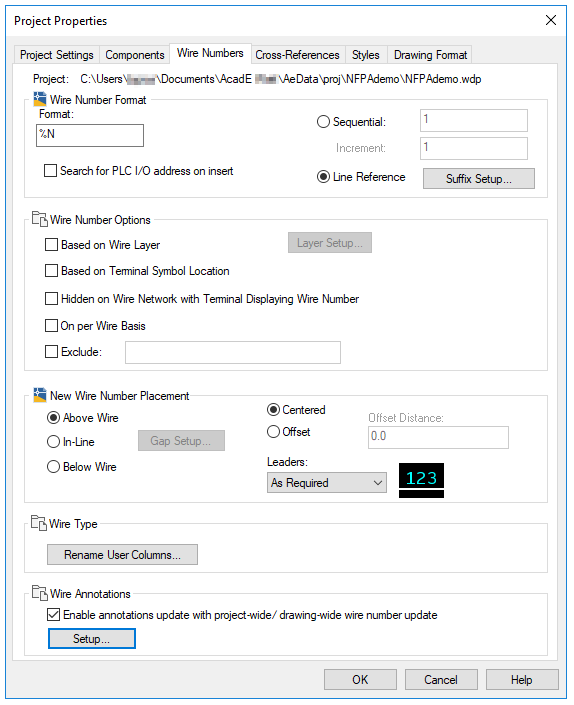

Wire Numbers
Use this tab to:
  • Set the wire number format.
  • Switch between sequential or line reference based wire numbers.
  • Set wire number options such as hidden numbers, excluded numbers, or displaying numbers on a per wire basis.
  • Set up wire number layer options.
  • Define wire number placement: above, below, or in-line.
  • Define wire number leaders.
  • Enable or disable wire number annotation updates during project-wide or drawing-wide wire number updates for panel footprints and terminal block representations, including graphical terminal strips, tabular terminal strips, and jumper charts.
