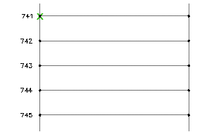

About Ladders
You can insert any number of ladders into a drawing. Ladders cannot overlap other ladders. You can insert a new ladder at any time.
Multiple ladder fragments in the same vertical column must be vertically aligned along their left-hand side. These limitations do not apply when X-Y Grid or X-Zone referencing is selected.
