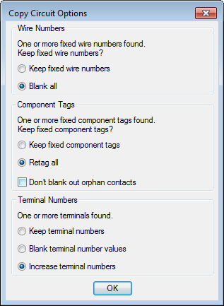

If you want to copy components and wires on the same drawing you can use the Copy Circuit command. Find
You can pick multiple insertion points to make multiple copies. Component tags update so they are unique. You can choose to update terminal numbers.

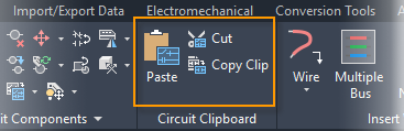

To copy components and wires from one drawing to another, use the Circuit Clipboard commands.
The Copy Clip or Cut commands put the components and wires on the Circuit Clipboard. Use the Paste command to place the objects on either the active drawing or another drawing. You may need to update terminal numbers since this command does not let you increase the terminal numbers.

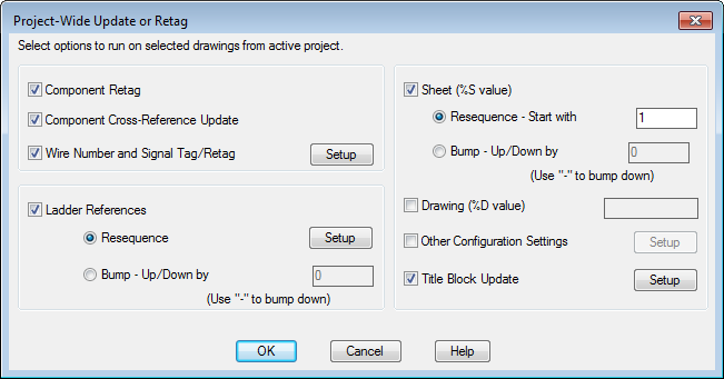

Project-Wide Updates
If you have a design that is similar to a previous one, you can copy and use those drawings in a new project. You probably will need to update the referencing system, retag components, reassign wire numbers, and more.
Use the Update/Retag command to update all this with one command. Find

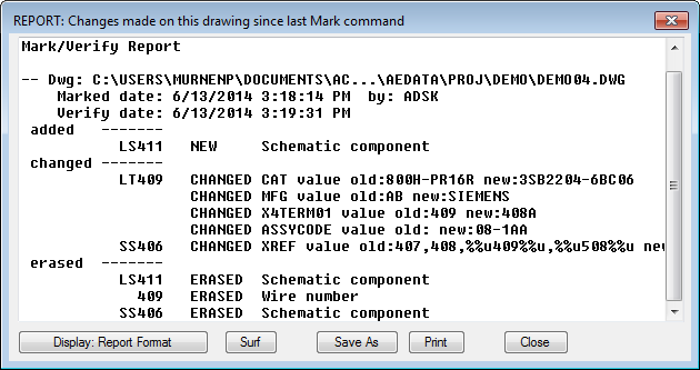

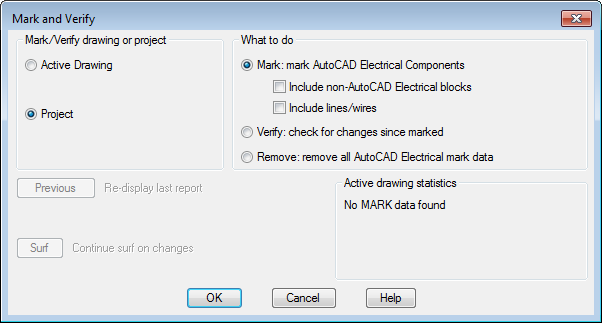

If you want to track changes that are made to your drawings, use the Mark\Verify command. Find
This command can track changes even if they are not made in AutoCAD Electrical toolset. Use the Mark option to create a starting point. AutoCAD Electrical toolset adds some invisible intelligence to each drawing and component.
When you want to see what changes were made after that point, run the same command and pick the Verify option. A report of all changes displays which you can print or use to surf to changed objects.
