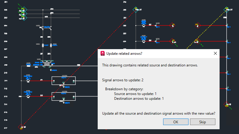

Signal code now allows you to synchronize all source and destination arrows using the same signal code.
When you update the signal code in one of the source arrows, the link between the source arrow to other source or destination arrows breaks in previous releases.
Now, the source and destination arrows with the same signal code in any drawing are all updated when the signal code in one of the source arrows is updated.
