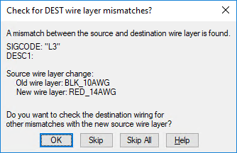

- In the Check for DEST wire layer mismatches dialog box, click OK.
- In the Choose Destination Wire Layers to Update dialog box, select the destination layer to update.
- Click Toggle.
- (Optional) Click Details to see more information about the wire type updates.
- Click Update.
