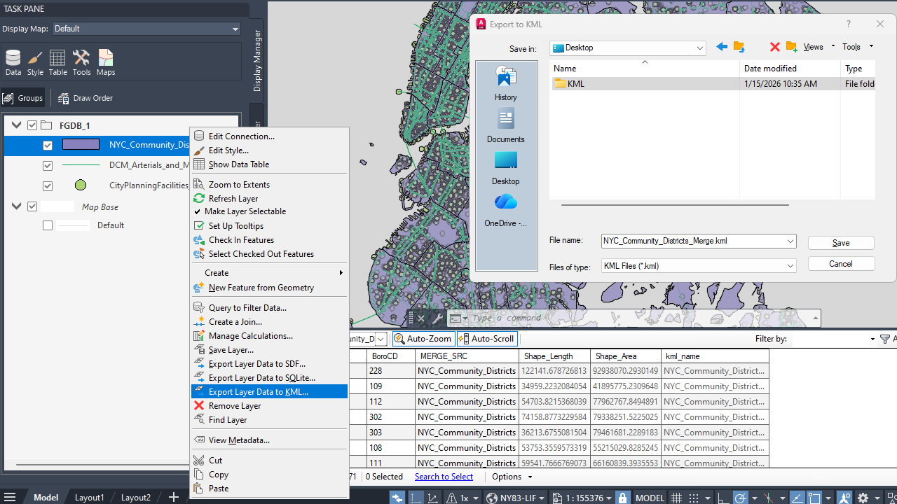

    • AutoCAD Map 3D now exports circles to KML accurately and displays them properly after reimporting the KML file into a drawing with a different coordinate system.
