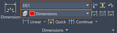

Set a Dimension Style as Current
Dimension styles establish and enforce drafting standards. By setting up your dimension style, you can specify virtually every aspect of a dimension's appearance and behavior.
The default dimension style is named either Standard (imperial) or ISO-25 (metric). It is assigned to all dimensions until you set another style as the current dimension style.
To access settings and tools related to dimensions, click the Annotate tab > Dimensions panel.
Try It: Select Your Dimension Style
In this exercise, choose your dimension style and set it current.
Open Bracket.dwg, linked above.
Click the Annotation tab > Dimension Style and set the DS1 dimension style current.
Set Dimensions as the current layer.

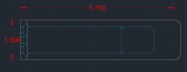

Add Linear Dimensions

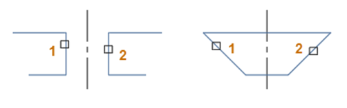

Horizontal, vertical, rotated, and aligned dimensions are useful for measuring distances between two points. Based on your design, you might dimension the length of a wall, the distance between the center of two holes, or the height of a feature shown in a section or elevation view.
You can create a linear dimension by:
Selecting a linear object or straight segment of an object, and then moving the cursor away from the selected object to place the dimension line.
Specifying two points and then moving the cursor away from the points to place the dimension line.
If points 1 and 2 are not on the same horizontal line, press Shift to force the dimension line to be horizontal.

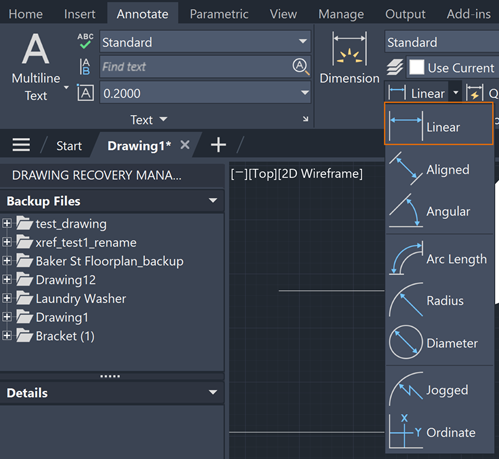

To create these dimensions, click Annotate tab > Dimensions panel > Dimension Types drop-down menu:
Linear: Creates a linear dimension with a horizontal, vertical, or rotated dimension line.
Aligned: Creates a linear dimension that is aligned with the origin points of the extension lines.

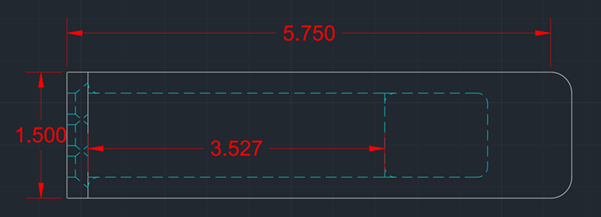

Try It: Add a Linear Dimension
In this exercise, try out creating linear and aligned dimensions.
Open Bracket.dwg.
Click Annotate tab > Dimensions panel > Linear.
When you see the Command prompt appear, press Enter to choose the Select object option.

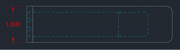

Select the top leftmost line, then drag to the left to draw the linear dimension. Your drawing should look like this:

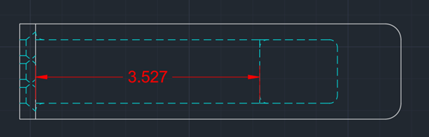

To create a linear dimension using two points, click Linear and then the two endpoints of the line you want to dimension. Do this with the top horizontal line. Your drawing should look like this:
To create an aligned dimension, click Aligned. Press Enter to choose the Select object option, then dimension one of the dotted blue lines. Your drawing should look this:

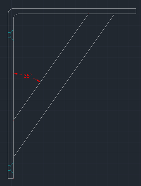

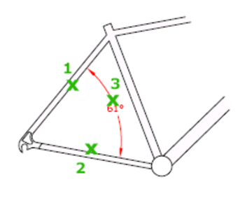

Add Angular Dimensions
Angular dimensions are used to communicate the angle of two lines or between three points. Based on your designs, you might use an angular dimension to indicate the angle of non-orthogonal walls in a floor plan or angles between gear teeth in a mechanical part.
Try It: Add Angular Dimensions
In this exercise, choose two sides of an angle to dimension.
Open Bracket.dwg.

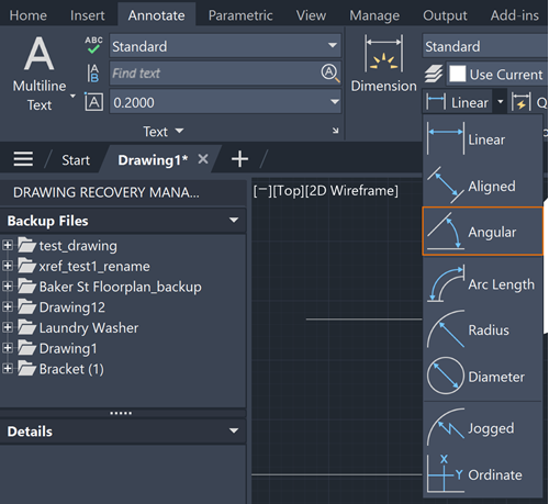

Click Annotate tab > Dimensions panel > Angular.
In the bottom left bracket, choose two sides of an angle and drag outwards to create an angular dimension.
Your drawing will look something like this:
Try this with the other angles in the drawing.

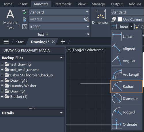

Click Annotate tab > Dimensions panel > Radius.

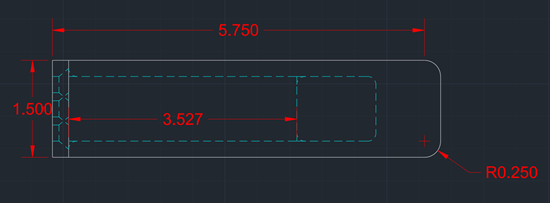

To measure radius, click an arc, such as the rounded corners in the top bracket. Your drawing will look like this:

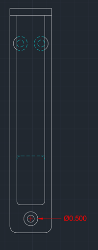

To measure diameter, click Annotate tab > Dimensions panel > Diameter.
Click a circle in the drawing. Your drawing will look something like this:

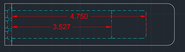

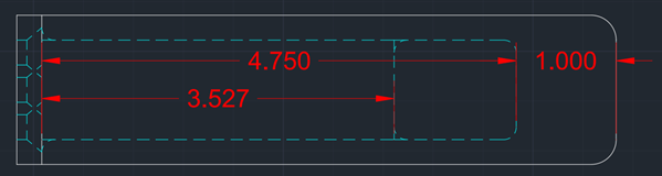

In the topmost bracket, draw a linear dimension for the bottom left dotted blue line. Your drawing will look something like this:
To draw a baseline dimension, click Annotate tab > Dimensions panel > Continue/Baseline drop-down menu > Baseline.
Select the origin point of the dimension line in the previous image.
Then drag out the dimension line to the end of the blue dotted line. Your drawing will look like this:
To draw a continued dimension, click Annotate tab > Dimensions panel > Continue/Baseline drop-down menu > Continue.
Select the end point of the longer dimension line from the previous image.
Drag the dimension line to the end of the white bracket. Your drawing will look like this:

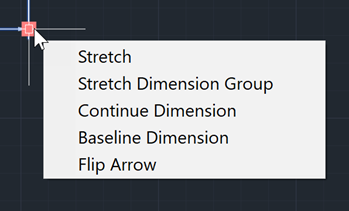

Move Dimensions
After you place a dimension, you might want to align it with another dimension or move the dimension text to make it easier to read. Use grips to move dimension lines and text.
To display the grips, select the dimension. Hover over a grip to see this context menu.
Then, choose Stretch or click the grip at the end of the dimension line to drag the dimension line. To relocate the dimension text, click the grip on the dimension text and drag.
