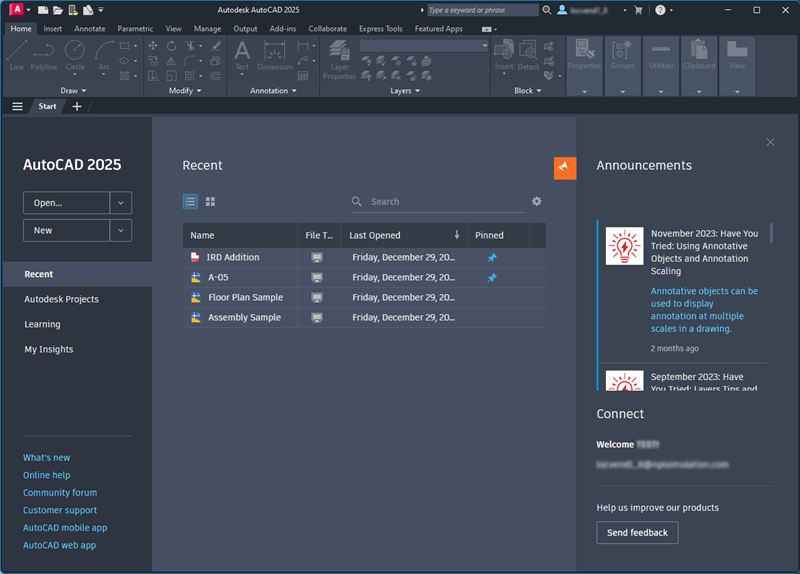

Navigate the Start tab
The Start tab provides easy access to create, open, save, and view drawings.
On the Start tab, click the Open drop-down to see the options.
- Open files - Open a previously saved drawing file.
- Open a sheet set - Open a previously saved sheet set.
- Explore sample drawings - Access the installed sample files.
On the left side, click Recent. Here, you can view recently opened drawings.
Below, click Learning to see learning resources such as videos and tips.
Click My Insights to see content recommendations personalized to you. As a new AutoCAD user, you may not yet have any insights available to you. After you've used AutoCAD for about a month, this area will show insights and suggestions based on your activity.

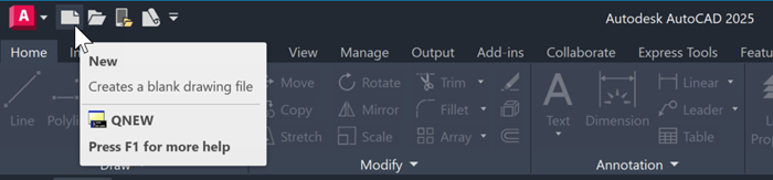

- On the Start tab, click New.
- Or, on the Quick Access toolbar, click New
, which will give you drawing template options to get started. A drawing template file contains predefined settings, standards, and definitions that will save you significant setup time.

On the Quick Access toolbar, click New.
In the Select template dialog box, select one of the following drawing template files based your associated industry and click Open.

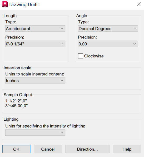

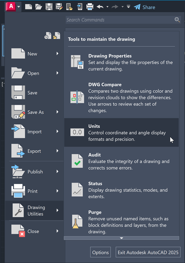

Click on Application menu > Drawing Utilities > Units to open the Drawing Units dialog box.
Under Length, select a Type, depending on what format you'd like for your drawing units. For example, if you are a mechanical engineer who normally works in millimeters, set the format for linear units to decimal. If you are an architect who normally works in feet and inches, set the format to architectural. The format settings available for linear units are as follows:
- Architectural. A length of 15.5 units displays as 1’-3 1/2”
- Decimal. A length of 15.5 units displays as 15.5000
- Engineering. A length of 15.5 units displays as 1’-3.5”
- Fractional. A length of 15.5 units displays as 15 1/2
- Scientific. A length of 15.5 units displays as 1.5000E+1
Make a selection under Precision to set the decimal or fractional rounding of values displayed on-screen.
Under Angle, select an angle type, precision, and direction for positive rotation for angular drawing units.
Click OK to save the settings.

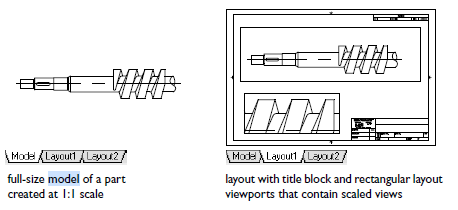

The Model and Layout tabs provide two working environments. In Model space, you can draw a full-size model of your object. With Layout space, you can create a layout of the same object from multiple angles.
Model space accesses a limitless drawing area. In model space, you first decide whether one unit represents one millimeter, one meter, one inch, or some other drawing unit. Next, you set the drawing unit format. Then you draw at 1:1 scale.
Layout space accesses drawing layouts. When you set up a layout, you specify the paper size you want to use. The layout represents a printed drawing sheet in which you can display one or more views of the model at various scales. This layout environment is called paper space. Here you create layout viewports that act as windows into model space. Each layout viewport can contain a different view of the model.

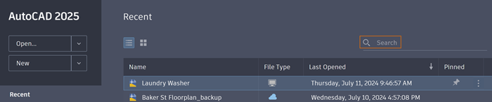

Or search for the file by name on the Recent tab in the Search bar.

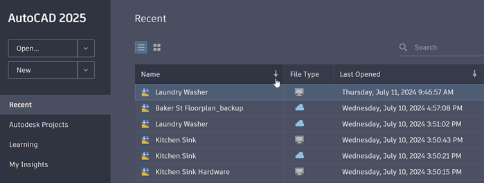

From the Start tab page, click Recent on the left-hand side to open a recently opened file. For more precise navigation, sort files by Name or Last Opened by clicking on the column headers, available only in list view.

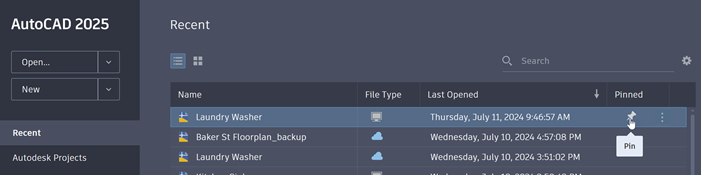

To Pin a Drawing
Pinned drawings will appear at the top of the Recent file list for easy access. From the Start tab page, click Recent, then the thumbtack to pin.

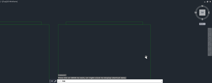

The easiest way to change the view of and navigate your drawing is to use the wheel on your mouse.
- Pan a view in any direction by holding the wheel down and then moving your mouse.
- Zoom in or out by rolling the wheel.
When you zoom in or out, the location of the cursor is important. Think of your cursor as a magnifying glass. For example, if you position the cursor in the upper-right area of the floor plan as shown below, rolling the mouse wheel magnifies that area without shifting it.

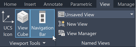

In the View tab and check that Navigation Bar is in blue. If not, click Navigation Bar to turn it on.

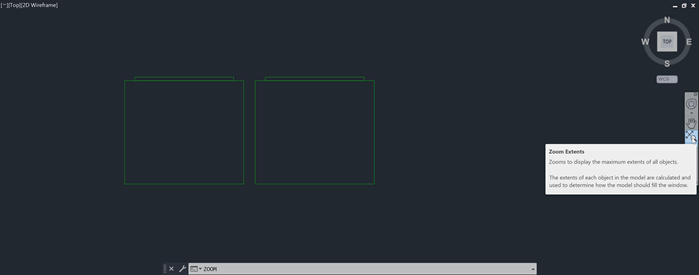

- On the Navigation Bar, click the Zoom drop-down menu and choose Zoom Extents.Find
The drawing zooms out to its extents.

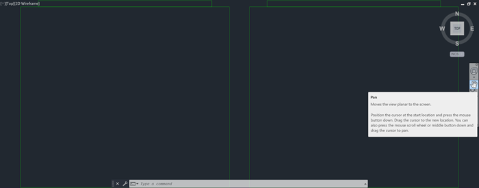

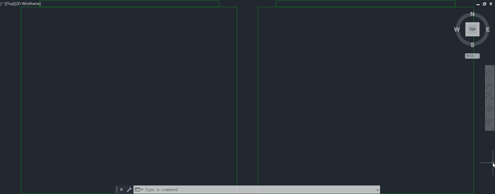

- On the Navigation Bar, click Pan.Find
Click and drag to move the view to a specific area of the drawing.

- To pan, hold the scroll wheel and drag to where you want to zoom.
