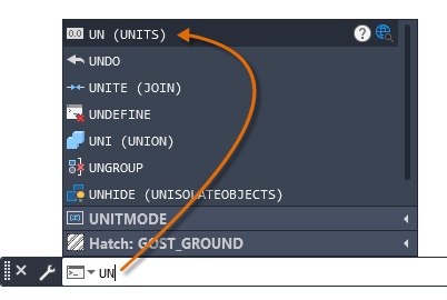

You can start a command by using the ribbon, toolbars, and menus at the top of the application. But the most efficient way to start a command on AutoCAD is the Command window, which is what we'll cover here.
Notice that as you start to type a command, it completes automatically. When several possibilities are available such as in the example below, make your choice by clicking it or using the arrow keys and then pressing Enter or the spacebar.

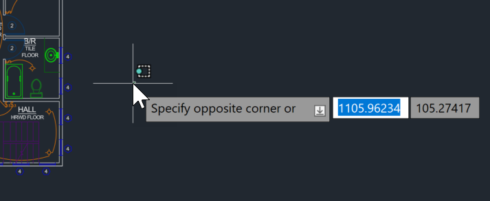

Use Dynamic Input
If your Dynamic Input is enabled, you will see a prompt at the cursor where you can enter commands and specify command options and values.

When you click in the drawing area and move the mouse, you are in object selection mode. Press ESC to cancel.

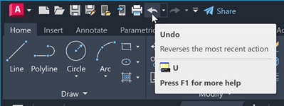

Undo (or Redo) Commands
Occasionally you will need to undo some of your work. Two standard toolbar buttons reverse mistakes in your drawings.
  • Undo. You can backtrack previous actions. For example, click Undo to delete an object that you just created.
  • Redo. You can reinstate the actions that you backtracked with Undo. For example, click Redo to restore the object you just deleted.
