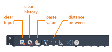

The basic QuickCalc controls are as simple and standard as you would expect. Using QuickCalc at its simplest, you can collapse the display to its most compact size (1) and then enter numbers and operators from your keyboard (2).
QuickCalc is limited to 8-9 decimal places of precision, which should be acceptable in most circumstances.
A particularly nice feature is Paste Value, which copies the current calculator result to the prompt in the Command window. This might be a computed radius, distance, or offset value.
Paste Value

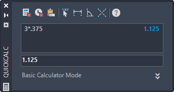

Distance Between provides an efficient way to obtain the distance between any two points and automatically paste it into QuickCalc so you can perform mathematical operations on that distance. Then, when you have the result, click Paste Value to copy it to the current prompt in the Command window.
For example, let's say that you want to move a circle a distance of 37.5% of the vertical dimension of a rectangle.
  1. Click Distance Between and specify the endpoints of the line segment corresponding to the vertical dimension of the rectangle.
    Let's say that the distance displayed in the input area is 3 units.
  2. Click inside the QuickCalc input area to the right of the 3, and type *.375. Press Enter to compute the value.
    The value of 1.125 displays.
  3. Start the Move command and specify the base point.
  4. Click Paste Value in QuickCalc.
    1.125 appears at the Specify next point prompt.
  5. Move the mouse in the direction that you want to move the circle, and then press Enter to accept 1.125 as the distance value.
