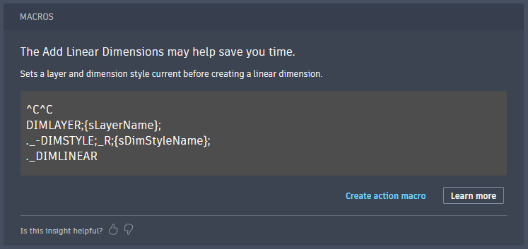

- Add Linear Dimension
				Sets a layer and dimension style current before creating a linear dimension. Defines the layer which new dimensions are to be placed and then sets a dimension style current before starting the DIMLINEAR command. Macro string: ^C^CDIMLAYER;{sLayerName};._-DIMSTYLE;_R;{sDimStyleName};._DIMLINEAR

Using a Recommended Action Macro
When My Insights recommends this type of macro, click the Create Action Macro option to create a new drawing and run a sequence of commands that results in the recording of a new action macro. The action macro is saved to your local drive and can be edited, played back, or shared with others. If you want to learn how to record your own action macros or share action macros with others, see Have You Tried: Putting the Action into Macros.

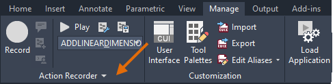

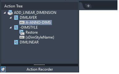

The following steps provide an overview of editing a recorded value of an action macro:
- From the ribbon, click Manage tab > Action Recorder panel and then choose the macro to edit from the Action Macro drop-down list.

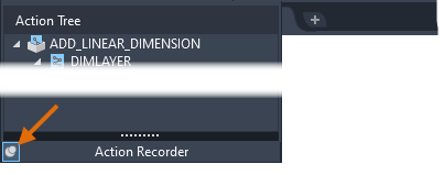

- Click the title of the Action Recorder panel to expand it.
- Click the pin button to keep the panel from collapsing.

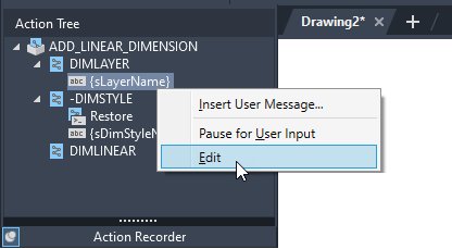

- In the Action Tree, right-click over a value node and choose Edit.
			 Here are some of the data types a value node might represent  Layer or object color Layer or object color
 Layer or dimension style name Layer or dimension style name
 Fillet radius or length Fillet radius or length
 Angle of rotation Angle of rotation
 Absolute coordinate point Absolute coordinate point
 For a full list of the node types in an action macro, see Action Node Icon Reference.
- Type the new value and press Enter.
- Repeat steps 4 to 5 for each value node that needs to be edited.
- When done editing the action macro, click the pin button again to allow the panel to collapse.

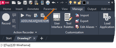

To use an action macro, do one of the following:
- At the Command prompt, enter the name of the macro just like you might for a standard AutoCAD command, such as LINE or ERASE.
- From the ribbon, click Manage tab > Action Recorder panel and choose the macro to playback from the Action Macro drop-down list. Once a macro has been chosen, click Play.

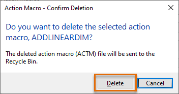

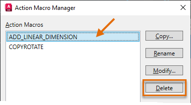

If you want to remove a previously recorded action macro, follow these steps:
- From the ribbon, click Manage tab > Action Recorder panel > Manage Action Macros (or enter ACTMANAGER at the Command prompt). Find
- In the Action Macro Manager dialog box, choose the action macro to remove and then click Delete.
- In the Action Macro – Confirm Deletion message box, click Delete.
- Click OK to close the Action Macro Manager dialog box.

- From the insight card, do one of the following:
			 - If there is a Copy to Clipboard option, click it to copy the macro string to the clipboard.
- If there is no Copy to Clipboard option, highlight the macro string in the box. Then right-click and choose Copy (or press Ctrl+C).

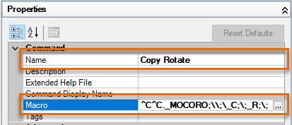

- In AutoCAD, from the ribbon, click Manage tab > Customization panel > User Interface. Find
- In the Customize User Interface (CUI) Editor, under the Commands pane, click Create A New Command.
- In the Properties pane, in the Name field, double-click and replace the default text of "Command1" with the name of the macro, such as "Copy Rotate" or "Multiple Fillet".
- Click in the Macro field and then click the Ellipsis button [...].
			 The Long String Editor dialog box opens.
- Select the current text. Then right-click and choose Paste (or press Ctrl+V) to paste the copied macro string from Step 1.

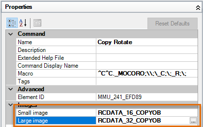

- Click in the Small Image field and enter
			 RCDATA_16_COPYOB.
			 RCDATA_16_COPYOB is the name of the icon assigned to the COPY command. You can use the Button Image pane to find the name of one of the icons that ship with AutoCAD. You can also choose a custom icon by clicking the Ellipsis button […]. Custom icons should be 16x16 or 32x32 pixels in size.
- Click in the Large Image field and enter RCDATA_32_COPYOB.
- Click Apply to save the changes.

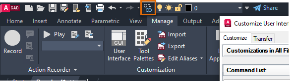

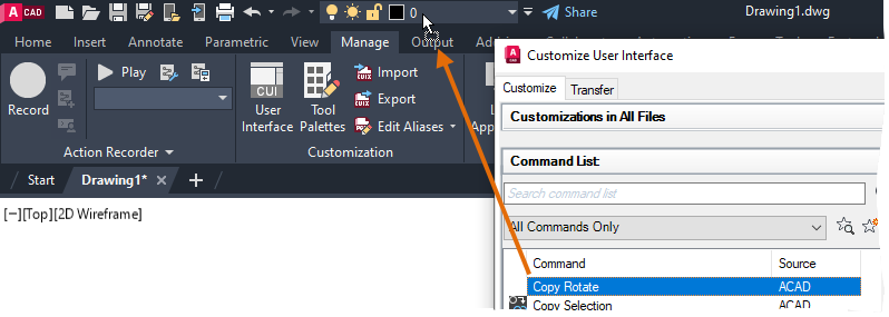

Now that you have created a command with the recommended macro, the following steps explain how to add the custom command to the Quick Access toolbar:
- In the Customize User Interface (CUI) Editor, under the Commands pane, select the command you just created.
- Click and drag the command onto the Quick Access toolbar (QAT) at the top of the AutoCAD application window.
- Move the mouse pointer over top of an existing button or control on the toolbar.
- When you see the cursor change to an arrow with a rectangle, release the mouse button to add the new command and shift the existing button to the right.
- Click OK to save the changes and exit the CUI Editor.
- Click the new button on the QAT to test the macro.
