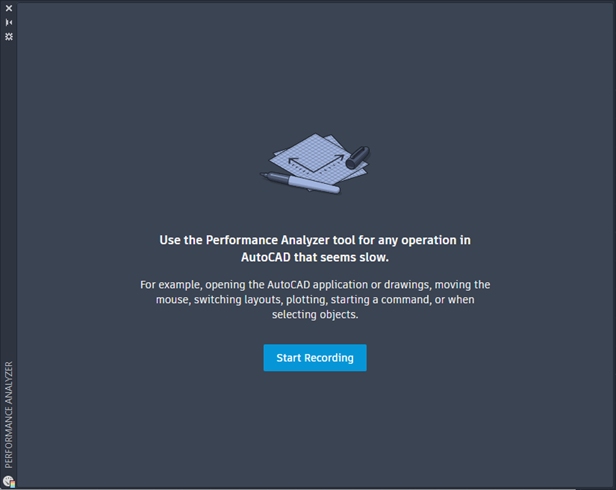

Opens the Performance Analyzer palette from which you can diagnose operations in AutoCAD that seem slow or unresponsive.
Find
Performance Analyzer can assist you with diagnosing operations in AutoCAD that seem slow or unresponsive.
Note: The Performance Analyzer must be run with Administrator privileges. For security reasons, it's always important to return to operating your computer under limited privileges.

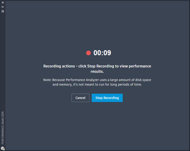

Start Recording
Starts the Performance Analyzer recorder.
Stop Recording
Stops the Performance Analyzer recorder and displays the results.
Cancel
Cancels the current recording resets to Start Recording.
