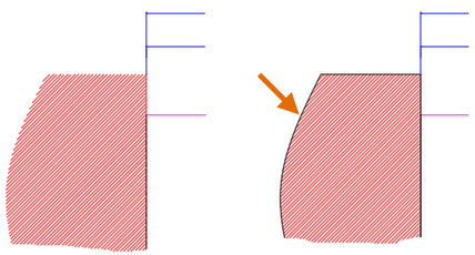

By default, hatch objects are associative, which means they are associated with the objects that define their boundaries. Associative hatch automatically adjusts when their boundary objects are modified. However, as objects are modified in a drawing, hatch objects can become disassociated if the boundary geometry is deleted or exploded.
Once a hatch object is no longer associative, you can do one of the following to reshape or adjust the hatch's boundary:
  • Select the hatch and modify it using grips. The hatch object updates accordingly but remains non-associative.
  • Recreate the boundary of the hatch and associate the new objects with the hatch to make it associative again. This can be done using the Recreate tool on the Hatch Editor contextual ribbon tab or the Recreate Boundary option of the HATCHEDIT command.

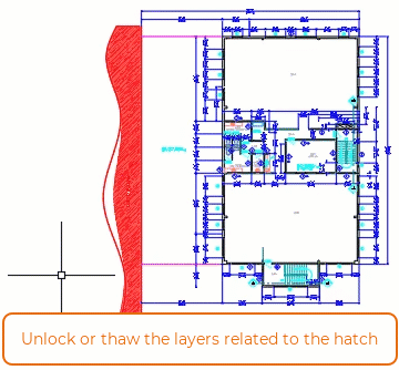

Associative Hatch Entity on Locked or Frozen Layer. No Update Performed.
When a hatch object is on a locked or frozen layer while its associated boundary is modified, the hatch object isn't updated. This causes the hatch object to no longer fill the newly defined boundary.
If you catch this issue right after editing the boundary of a hatch object, you can undo the edits and then unlock or thaw the layer before redoing the edits to the boundary objects. However, if you didn’t catch the issue right away, you can do the following to update the hatch object:
  1. Unlock or thaw the layers on which the hatch and boundary objects are placed.

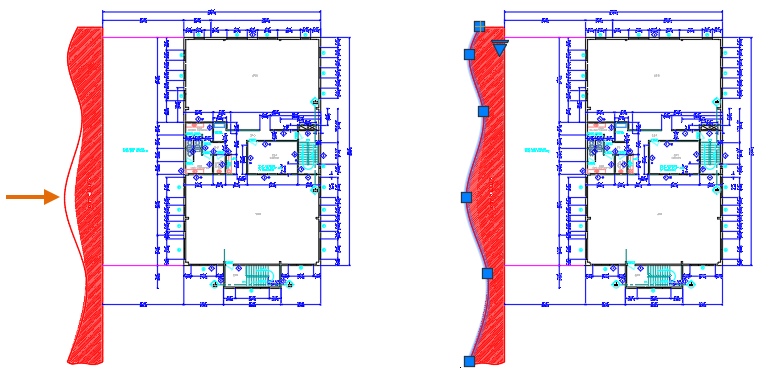

  2. Select one of the hatch's boundary objects.
  3. Select one of the grips that are displayed.
  4. Click the same grip point as the selected grip.
    The boundary is not stretched but the hatch updates to the fill the current boundary.
