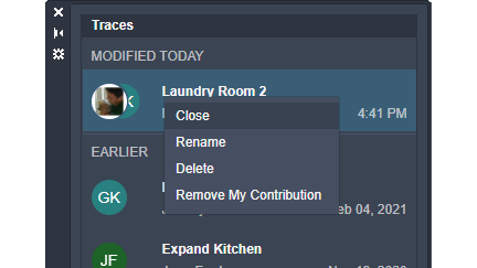

- Click Create Trace on the palette.
The new trace is added to the palette and becomes active.
- Right-click and select Rename to rename the trace.
Note: You can also use the new option in the TRACE command.

Remove Your Contribution
- Right-click the trace name on the Traces palette.
- Select Remove my Contribution.
Note: You can't remove contributions made by others.

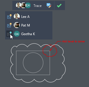

View Contributions
Click the avatar on the toolbar to see who has contributed to the active trace.
If there are contributions from others, you can do the following:
- Hover over the contributor's name on the toolbar's drop-down to highlight their contribution to the trace.
- Click the icon next to the contributor's name to hide or display their contributions.
