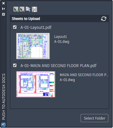

Sheets to Upload
Lists the AutoCAD layouts from the selected drawings.
- select a drawing to add the layouts to the list of available sheets
- remove the selected layouts from the list of sheets
- load a previously saved list of sheets
- save the current list of sheets to a file for easy retrieval

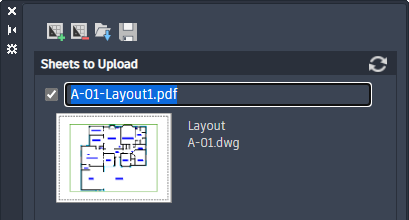

PDF File Name
By default the PDF file name is <drawing name>-<layout name>.PDF. Click the file name to edit in place.

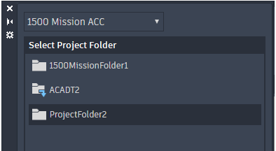

Select Folder
Displays your available projects on Autodesk Docs.
Select a project from the drop-down menu, then select a folder within that project. Click OK to upload the selected layouts as PDFs to the project's folder.
