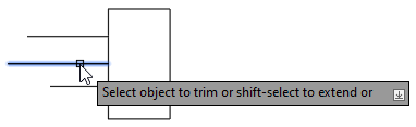

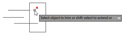

  4. At the Select object to trim or shift-select to extend prompt, select near the endpoints of the lines that intersect the rectangle to trim each line.
    Note: Before you select the object to trim, AutoCAD provides you with a preview of the change that will be made.
  5. Now hold the Shift key and select the other line to extend it to the rectangle. Release the Shift key to exit extend mode.

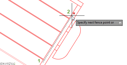

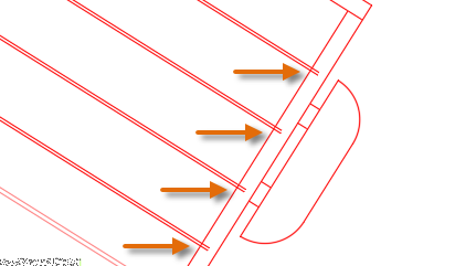

Fence Selection
Individually selecting objects to trim and extend can be time-consuming. Both the TRIM and EXTEND commands support the ability to use fence selection which lets you select multiple objects.
  1. Create a new drawing or open a drawing with known intersecting geometry.
  2. Click Home tab > Modify panel > Trim. Find
  3. If the Select objects or <select all>: prompt is displayed, press Enter to select all objects as cutting edges.
  4. At the Select object to trim or shift-select to extend prompt, type F and press Enter.

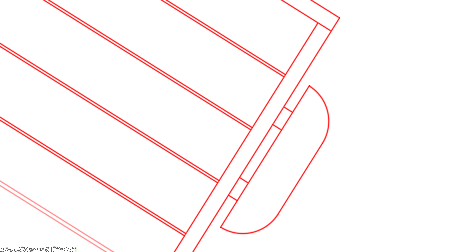

  5. Specify the first and second points of the fence selection so they intersect the objects to be trimmed, or extended if you are holding the Shift key.
  6. Continue to specify points to define the fence selection, as needed.
  7. Press Enter twice to end fence selection, trim the selected objects, and end the TRIM command.
