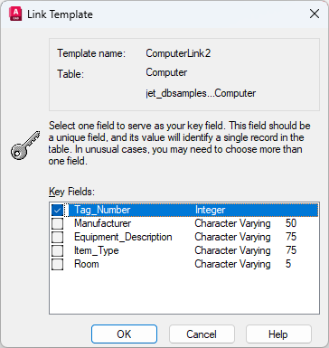

Link Template Dialog Box (dbConnect Manager)
Specifies the key fields that are used by a link template.

Template Name
Displays the name of the link template.
Table
Displays the current database table. The first line lists the name of the table, and the second line lists the full data source path to the table in the following syntax: environment.catalog.schema.table
Key Fields
Displays all fields that are available for the current database table, as well as the field type and, in the case of character fields, the field length. You specify the link template's key fields by selecting the check box to the left of the field name.
