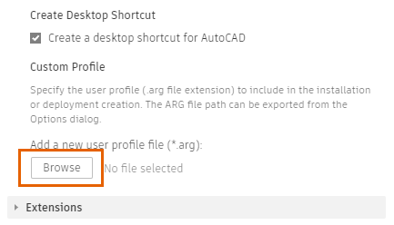

Create a Deployment
  1. Create the online deployment (see Installation for administrators).
  2. While creating the deployment, browse to the profile .arg file created.
