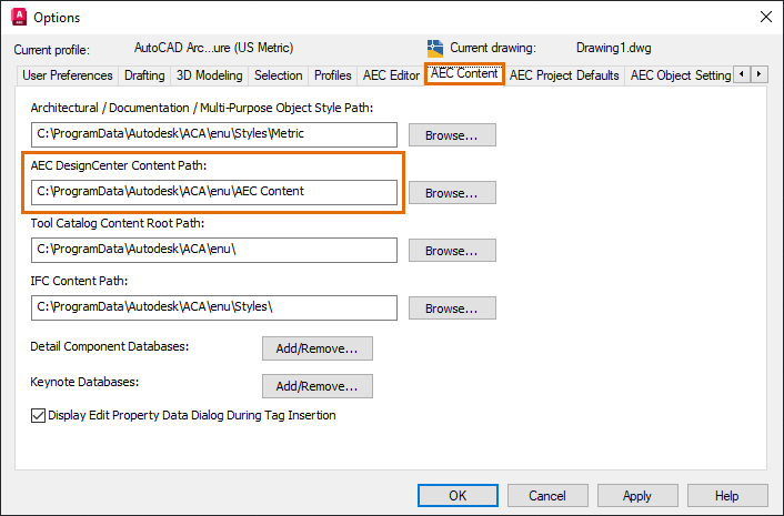

  2. To locate the content pack files, enter OPTIONS in the command line. In the Options dialog box, select the AEC Content tab.

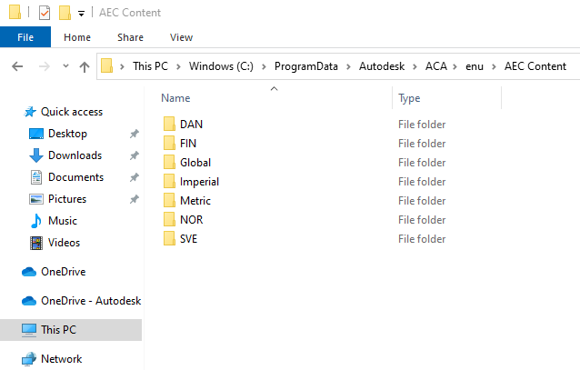

  3. Copy the path from AEC DesignCenter Content and open this path in File Explorer.
  4. Delete the AEC content pack folder which you want to remove.

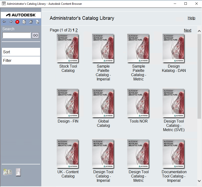

  2. Enter CONTENTBROWSER in the command line or select Tools -> Content Browser.

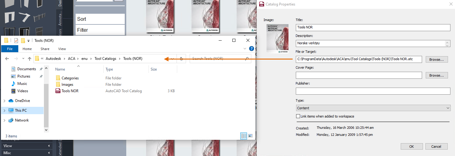

  3. Go to the catalog location where its dependent tools and files are located. By default, all tool catalogs are placed at C:\ProgramData\Autodesk\ACA {release}\enu\Tool Catalogs.
    1. You can also find the location of catalog content by selecting the catalog which you wish to remove from the content browser. Right-click the catalog and select its properties.
    1. In the Catalog Properties dialog box, copy the file path and open in File Explorer.

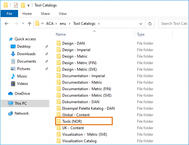

    1. Go one level up to the Tool Catalogs folder.
    1. Close the Catalog Properties dialog box.
    Note: Make a backup copy of the content folder in a separate folder if you want to restore it in the future.
  4. Select the folder/content that is not needed in the content browser and delete the whole folder. For example: Tools (NOR) folder.
  5. You can also remove the catalog shortcut from the content browser. Select the catalog again, right click the catalog, and choose "Remove <tool catalog name> from library".
  6. Click Yes to confirm.
