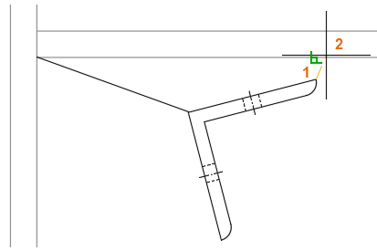

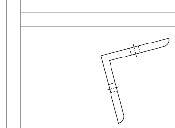

You can move, rotate, and scale selected objects in a single operation based on geometry in a drawing. The following steps move and rotate a "L-shaped" bracket to the intersection of a column and beam.
  1. In an open drawing, locate the objects in the drawing that you want to align with other geometry.
  2. On the ribbon, click Home tab > Modify panel (expanded) > Align. Find
  3. Select the objects you want to align.

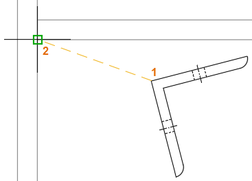

  4. Specify the indicated point on the selected objects (1) as the source point and then the second point (2) on the geometry as the destination point.
  5. Specify a point on the selected objects (1) as the second source point and a point (2) as the second destination point.
    The first and second point pairs move and rotate the selected objects by reference.

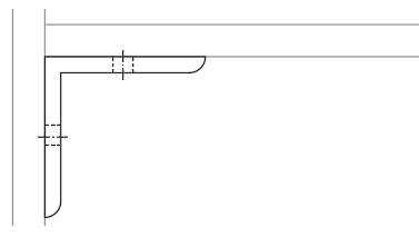

  6. Press Enter to use just these two point pairs of points.
    Note: You can specify a third point pair to rotate the selected objects in 3D.
  7. At the prompt, Scale objects based on alignment points, enter N.
    This leaves the selected objects unscaled.
    If you do want to scale the objects by reference, enter Y and the selected objects will be scaled to match the length between the two destination points.
