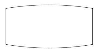

  1. Open a new drawing, draw a rectangular object that is 30”x72” to represent a conference table. Not all conference tables are rectangular, so feel free to add some curved edges.

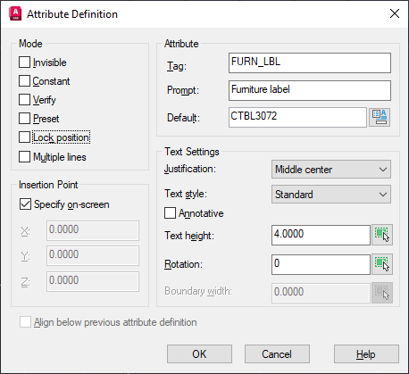

  2. Enter ATTDEF at the command prompt.
  3. In the Attribute Definition dialog box, specify the values shown in the following image:
    The properties in the Attribute section are used to control the text that is displayed in a drawing and the value assigned to the attribute.
    • Tag - Visible placeholder text that is displayed in the drawing window prior to the attribute being added to a block; value provided is used to identify the attribute when extracting values from a block.
    • Default - Replaces the Tag and is the value assigned to the attribute upon the insertion of a block.
    • Prompt - Message string displayed in the Edit Attributes dialog box or at the Command prompt during the insertion of a block to let you know the type of information an attribute expects.

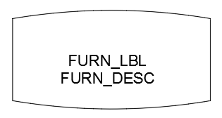

  4. Accept the values provided and specify the insertion point for the attribute, the best place is inside of the geometry that defines the conference table.

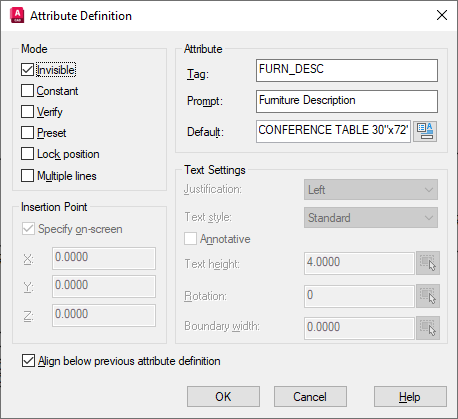

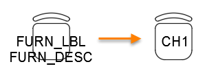

  5. Start the ATTDEF command again to create a second attribute definition, and specify the values shown in the following image:
    Note: The Invisible mode suppresses the visibility of the attribute on-screen and keeps the drawing from looking too crowded, while still providing the benefits of being able to add information to a block. The visibility of hidden attributes can be toggled with the ATTDISP command.

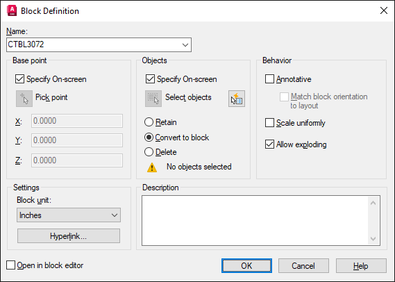

  6. Enter BLOCK at the command prompt.
  7. In the Block Definition dialog box, specify the values shown in the following image:
  8. Accept the values provided and specify the center of the table as the base point for the block.

  9. Select the geometry of the table, and then select the FURN_LBL attribute followed by the FURN_DESC attribute.
    Note: The prompt order for attribute values is determined by the order in which attributes were selected while defining a block; this order can be important when creating scripts or AutoLISP programs. The BATTMAN command can be used to change the prompt order of attributes in a block.

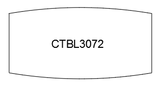

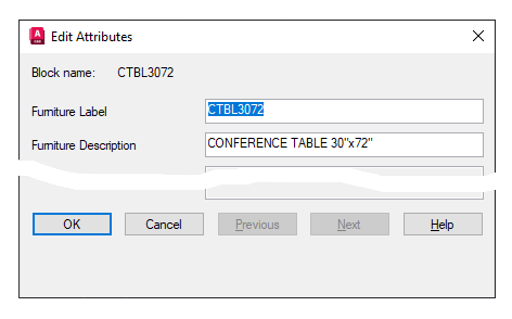

  10. In the Edit Attributes dialog box, accept the default values.

  4. In the Edit Attributes dialog box, edit the default value for each attribute as needed.

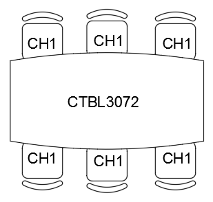

  5. Insert several of the conference chair blocks along the two longer sides of the conference table.

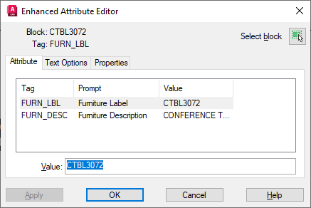

After inserting a block with attributes, you can double-click the block to edit the current value of each attribute in the block.
