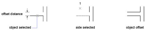

You can offset an object at a specified distance or through a point. After you offset objects, you can trim and extend them as an efficient method to create drawings containing many parallel lines and curves.

Offset Distance
Creates an object at a specified distance from an existing object.
