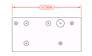

Adds or removes inspection information for a selected dimension.
Find
Inspection dimensions specify how frequently manufactured parts should be checked to ensure that the dimension value and tolerances of the parts are within the specified range.
The Inspection Dimension dialog box is displayed and allows you to add or remove inspection dimensions from an existing dimension.
