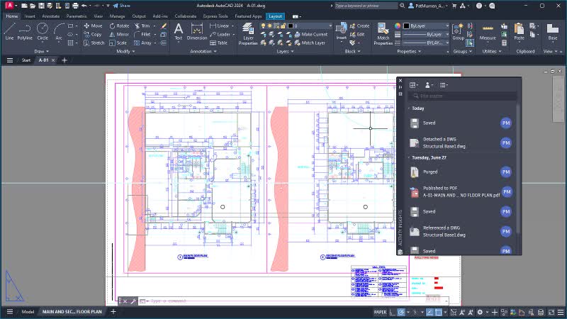

Activity Insights tracks drawing activities and displays them on a palette when the drawing is open in AutoCAD.
From this palette you can see if your drawing is referenced in another drawing, when it was last published, when it was edited and by whom, and more. For better collaboration, store drawing files to a shared location.

So, what activities might you see for your drawings? Let's try a few commands and see what shows up on the Activity Insights palette. You can use your own drawings for these exercises or download the sample drawings.
Note: Activities are logged even when the palette is closed. All activities are displayed the next time the palette opens.
  1. Open A-01.dwg or a drawing of your own.
  2. Click Plot, select a plotter or PDF output device, and click OK. Find
    The Published activity displays on the palette.
    Note: The specific published activity depends on the device or output selected.
  3. Click Purge, select All Items, and click Purge All. Find
    The Purged activity displays on the palette.
  4. Draw some geometry, for example some circles and lines.
  5. Save the drawing.
    The Saved activity displays on the palette.
    Note: Some activities don't display on the palette until after you save the drawing.
