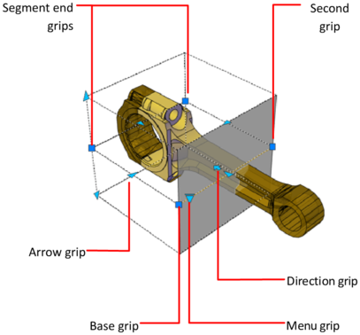

Section object grips help you move and resize the section object.
Grips allow you to adjust the location, length, width, and height of the cutting area.
  • Base grip. Acts as the base point for moving, scaling, and rotating the section object. It is always adjacent to the menu grip.
  • Second grip. Rotates the section object around the base grip.
  • Menu grip. Displays a menu of section object states, which control the display of visual information about the cutting plane.
  • Direction grip. Controls the viewing direction of the 2D section. To reverse the viewing direction of the section plane, click the Direction grip.
  • Arrow grip. Modifies the section object by modifying the shape and position of the section plane. Only orthogonal movements in the direction of the arrow are permitted. (Section Boundary and Volume states only.)
  • Segment end grips. Stretches the vertices of the section plane. You cannot move segment end grips so that segments intersect. Segment end grips are displayed at the endpoints of jogged segments. (Section Boundary and Volume states only.)
You can select only one section object grip at a time.
