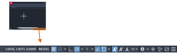

The status bar provides quick access to some of the most commonly used drawing aids and tools. Here is the default status bar.
Where is it
The status bar displays in the lower-right corner of the application.

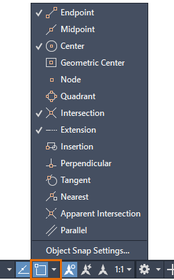

Note: The blue background indicates a feature is on. - Click on the arrow, or right-click anywhere on the Object Snap icon, to display the associated menu.
- Check or clear individual object snap settings.
- Click Object Snap Settings to open the Object Snap tab of the Drafting Settings dialog box.
