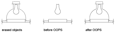

OOPS (Command)
Restores erased objects.
OOPS restores objects erased by the last ERASE command.
You can also use OOPS after BLOCK or WBLOCK because these commands have options that can erase the selected objects after creating a block.
You cannot use OOPS to restore objects on a layer that has been removed with the PURGE command.
