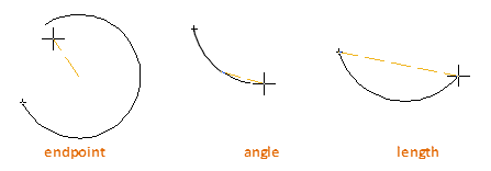

Endpoint of arc
Completes an arc segment. The arc segment is tangent to the previous segment of the polyline.
Angle
Specifies the included angle of the arc segment from the start point.
Entering a positive number creates counterclockwise arc segments. Entering a negative number creates clockwise arc segments.
Center
Specifies an arc segment based on its center point.
Note: For the Center option of the PLINE command, enter ce; for the Center object snap, enter cen or center.
Direction
Specifies the tangent for the arc segment.
  • (2) Tangent direction from the start point of the arc. Specifies a point that establishes a tangency of the curve to the start point. The arc curves away from the vector between the start point and the tangent point.
  • (3) Endpoint of the arc. Specifies the endpoint of the arc segment.
Tip: Press Ctrl to draw in a clockwise direction.
Line
Switches from drawing arc segments to drawing straight segments.
Radius
Specifies the radius of the arc segment.
Second pt
Specifies the second point and endpoint of a three-point arc.
