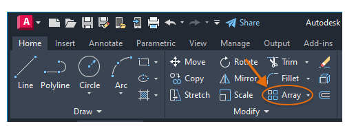

Create an Associative Array
  1. Click Home tab > Modify panel > Rectangular Array.
  2. Select the objects to array, in this case the rectangle, and press Enter.

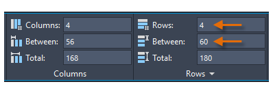

    A default rectangular array is displayed, but the number and spacing of the display cases needs to be modified.
  3. Modify the values of the array by using the controls on the Array ribbon contextual tab.
    The results can easily be modified iteratively by changing the values for Columns, Rows, and the distances between the rows and columns.
    Note: The "Between" value under Rows is always measured relative to equivalent locations on the arrayed items, as shown.

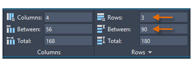

    This option replaces all instances of the original items in the array, but the number of rows and vertical spacing now needs to be adjusted.
  5. With the array still selected, you can adjust the values on the Array ribbon contextual tab. In this case, let's choose 3 rows and 90 as the Between distance under Rows. Press Enter to update the array.
Here's the final result of the Replace Item operation.
