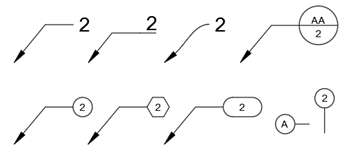

Some of the most common annotations in a drawing are labels and callouts. These convey various types of information and identifications depending on their content and symbols. The most advanced tool available for creating these objects in AutoCAD is the multileader tool, MLEADER. Here are some examples of multileaders that you can easily create.
The primary benefits of using multileaders over other methods include the following:
  • A single, easily adjustable object with convenient grips
  • Access to different types of labels and callouts with multileader styles
  • Efficient edit and alignment options

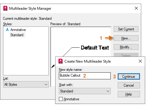

  2. In the Multileader Style Manager, click New (1), type Bubble Callout as the new style name (2), and click Continue (3).

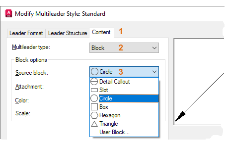

  3. Next, click the Content tab (1), change the multileader type from Mtext to Block (2). For the Source Block, choose Circle (3). Then click OK.

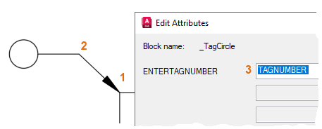

  4. Using the Endpoint object snap, click a corner of the rectangle to specify the arrowhead location (1). Then click a location for the leader landing (2), type a letter or numeral in the Edit Attributes dialog box (3), and click OK.

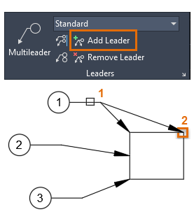

  2. Click the Add Leader tool and select the top multileader (1). Specify another point on the rectangle (2).

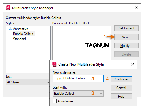

  1. Open the Multileader Style Manager again and click New (1).
  2. In the Create New Multileader Style dialog box, choose Start with: Bubble Callout, if necessary (2), type Column Labels and as the new style name (3), and click Continue (4).
