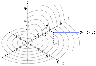

3D spherical coordinates specify a location by a distance from the UCS origin, an angle from the X axis in the XY plane, and an angle from the XY plane.
You specify a point using the following syntax:
X < angle from X axis < angle from XY plane
In the illustration below, dynamic input is turned off, so 5<45<15 indicates a point 5 units from the UCS origin in the XY plane, 45 degrees from the positive X axis in the XY plane, and 15 degrees up from the XY plane.
