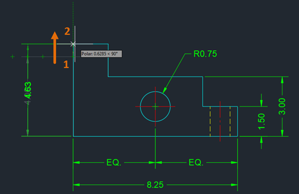

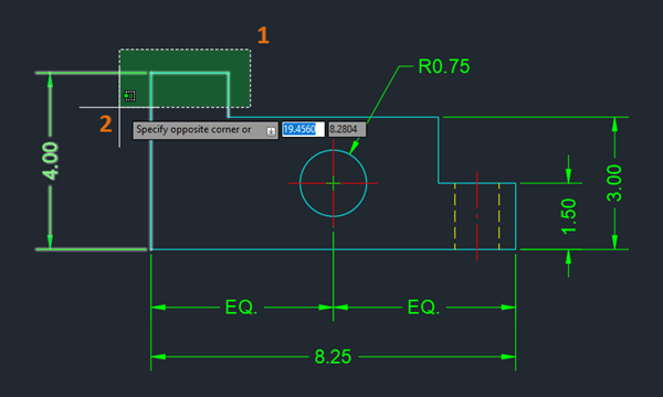

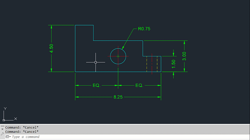

For our exercise, let's make a few changes to a simple machined part.
  1. Create a drawing similar to what is shown below.
  2. Click Home tab > Modify panel > Stretch. Find
    You can also enter STRETCH at the Command prompt.
  3. Create a crossing selection window by specifying two points going from right to left to select the geometry to stretch.
    Note: See Have Your Tried: Window, Fence, Lasso, and More for tips on selecting objects.

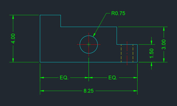

    Using a crossing selection method not only selects one or more objects to be stretched but more importantly encloses all points that are to be repositioned.
  4. At the Specify base point prompt, choose a reference point (1) and drag the objects to the desired location (2).

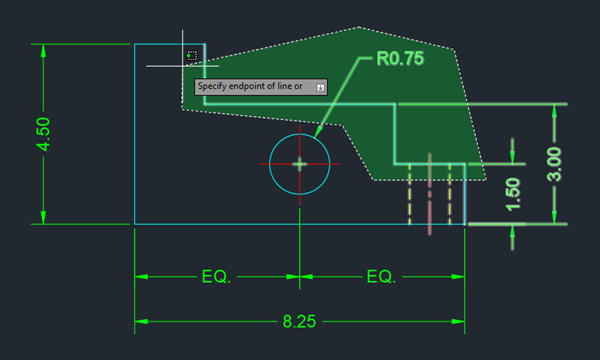

As drawings develop and become more complex, selecting objects can get more challenging. The crossing polygon or crossing lasso selection methods can be used for more precise object selecting. In the example below, a crossing polygon is more effective in selecting desired geometry while avoiding unwanted geometry. A crossing lasso selection could have also been used.
Tip: If you accidentally select objects that you don't want to modify, hold down the Shift key and select the objects to remove from the current selection.
It's also possible to make multiple selections within one STRETCH command. You just continue using crossing selection methods until all desired objects and points are included.

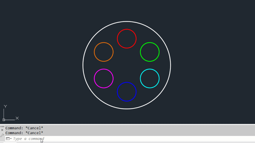

As explained earlier, crossing selection methods help to select the objects to modify and the points to be stretched. When working with lines, polylines, or arcs, these points are easy to see and select. But what happens when the STRETCH command encounters a circle?
You can see that five circles are selected but only two are modified. Only the two circles whose center points are enclosed by the crossing window selection are modified.

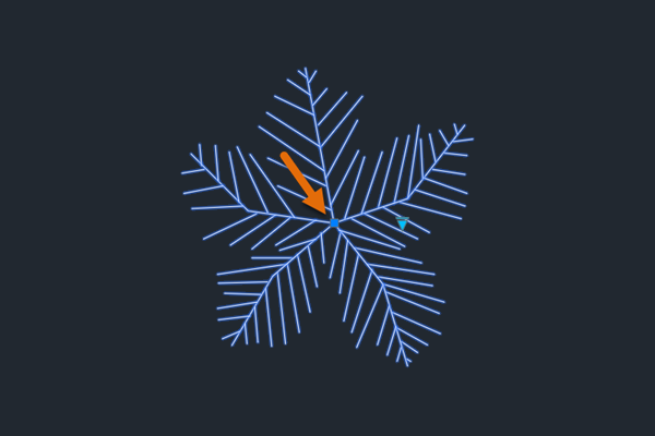

  3. Select the Trees - Imperial block from the palette and click anywhere in the drawing area to place the block.
    The default view is a plan view of a palm tree.
  4. Select the block.
    The insertion point grip (the square grip at the center of the tree) displays. This is important to know when using the STRETCH command.
    Note: If you don't see the insertion point grip after selecting the block, set the GRIPBLOCK system variable to 0.
  5. Press Esc to deselect the block.

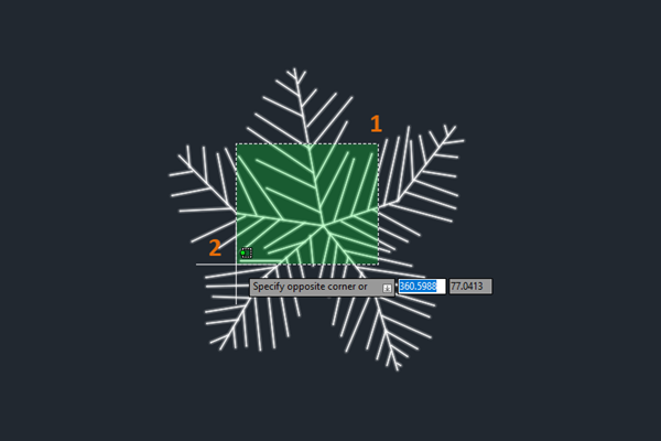

  6. Click Home tab > Modify panel > Stretch. Find
  7. Select the block using a crossing window. Make sure to include its insertion point in the selection.
    The entire block geometry doesn't have to be enclosed in the crossing selection.

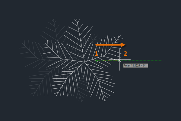

  8. Specify a base point (1) and then specify a second point (2).
    The block is moved rather than its geometry stretched.
    Note: Other objects with insertion points (multiline text, xrefs, arrays, images, PDF attachments, and so on) behave in a similar fashion. The objects are affected by a STRETCH only if the insertion point is enclosed by the crossing selection method.

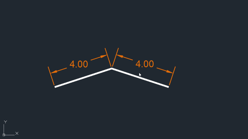

The LENGTHEN Alternative
The word stretch is commonly defined as a process of making something longer, which the STRETCH command can certainly do. There is also a more specialized command, LENGTHEN, that you can explore. The primary advantage LENGTHEN offers is the ability to change the length of an object while retaining its angle (for lines and polylines) or its radius (for arcs and ellipses). Let's try this simple exercise.

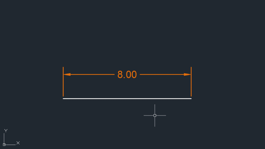

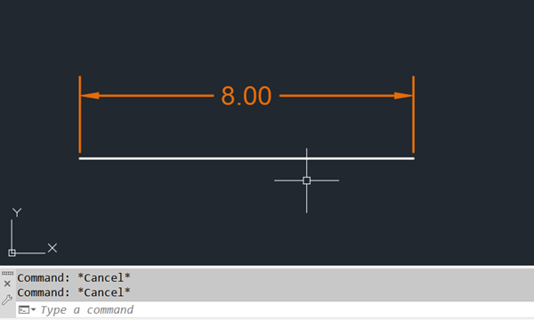

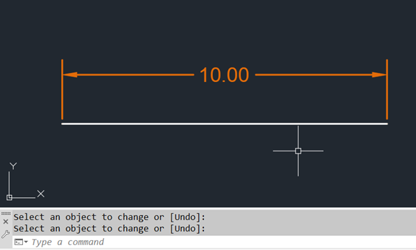

  1. Draw a line or polyline that's eight units long.
    An associative dimension was added to show the length as the line changes.

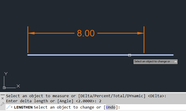

  2. Click Home tab > Modify panel > Lengthen. Find
    Alternatively, at the Command prompt, enter LENGTHEN.
    At the Command prompt, you can optionally select an object to find its current length.
  3. At the Command prompt, enter DE or choose the Delta option.
    When using the Delta method, you specify how much the current length should change.
  4. Enter a delta of 2.
  5. Select near the end of the line to define the direction in which it should be lengthened.
    Note: If your COMMANDPREVIEW system variable is set to 1, you will see a preview of the final result before selecting the line. For more information see Have You Tried: Command Preview.
  6. (Optional) Continue selecting lines that you want changed by two units.
  7. Press Enter to end the command.
