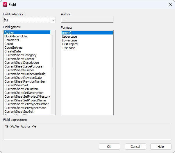

Field Dialog Box
Inserts a multiline text field that can be updated automatically as the field value changes.
FIELD (Command) Find
The options available change based on the selected field category and field name.
List of Options
The following options are displayed.
Field Category
Sets the types of fields to be listed under Field Names (for example, Date & Time, Document, and Objects).
Field Names
Lists the fields that are available in a category. Select a field name to display the options available for that field.
Field Value
Displays the current value of the field, or displays an empty string (----) if the field value is invalid.
The label for this item changes with the field name. For example, when Filename is selected in the Field Names list, the label is Filename and the value is the name of the current drawing file. The label is Property for object fields. Exception: when a date field is selected, the selected date format is displayed; for example, M/d/yyyy.
Format List
Lists options for display of the value of the field. For example, date fields can display the name of the day or not, and text strings can be uppercase, lowercase, first capital, or title case. The value displayed in the Fields dialog box reflects the format that you select.
Field Expression
Displays the expression that underlies the field. The field expression cannot be edited, but you can learn how fields are constructed by reading this area.
