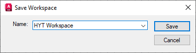

  3. In AutoCAD, on the status bar, click Workspace Switching. Find
  4. On the menu, choose Save Current As.
  5. In the Save Workspace dialog box, type HYT Workspace and click Save.
    The new workspace is created and set current.

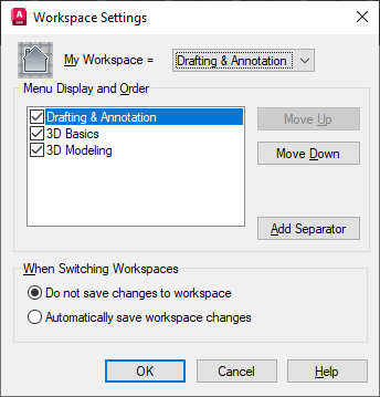

Note: Any changes to the current workspace are lost when switching workspaces. You can use the Workspace Settings dialog box (WSSETTINGS command) or the WSAUTOSAVE system variable (not available in AutoCAD LT) to control whether changes should automatically be saved before switching workspaces. The Workspace Settings dialog box can also be used to control the order and which workspaces appear on the Workspace Switching menu.

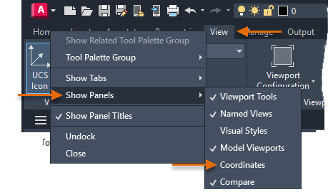

Show and Hide Ribbon Tabs and Panels

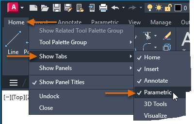

The display state of a ribbon tab or panel can be changed based on whether you use the tools that are part of that logical grouping. If you right click over any tab, you can see which tabs are currently displayed (checkmark in front of the name) and those that are currently hidden. You can also right-click over the current tab to see which panels are currently displayed or hidden for that tab.

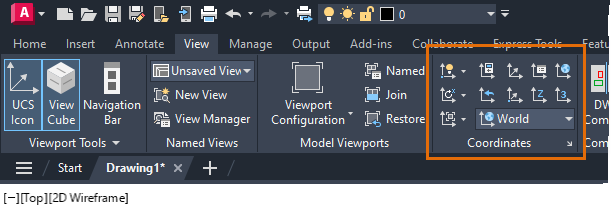

In this exercise, you'll hide the Parametric ribbon tab and show the Coordinates panel on the View tab.
  1. Make sure the HYT Workspace is the current workspace.
  2. On the ribbon, right-click over any tab on the ribbon and choose Show Tabs > Parametric.
    The checkmark in front of the Parametric tab should now be removed and the tab should be hidden in the interface.
  3. On the ribbon, click the View tab.
  4. Right-click over the View tab and choose Show Panels > Coordinates.
    A checkmark should now be placed in front of the Coordinates tab on the menu and the Coordinates panel should now be displayed on the View tab.
  5. Save the changes to the HYT Workspace.

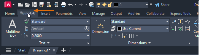

Reorder Ribbon Tabs and Panels
Sometimes you might not want to hide a panel or tab but move it on the ribbon to a different place. You can visually reorder ribbon tabs and panels by doing one of the following:
  • Drag a ribbon tab horizontally along the top of the ribbon to reposition the tab.
  • Drag a ribbon panel's title bar horizontally along the ribbon to reposition the panel.
In this exercise, you'll reposition the Annotate tab and Dimensions panel.
  2. On the ribbon, click and hold the mouse pointer button over the Annotate tab.
  3. Drag to the left of the Insert tab and release the mouse button.
  4. On the Annotate tab, click and hold the mouse pointer button over the Dimension panel's title bar
  5. Drag to the left of the Text panel and release the mouse button.

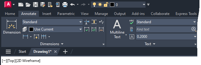

    The ribbon should now look like the following image.

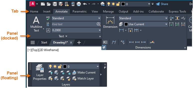

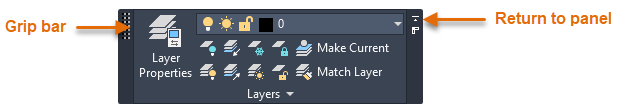

Float a Ribbon Panel
Panels on a ribbon tab can be made to float in the application window. When a ribbon panel is floating, it is visible no matter which ribbon tab is active. This can be very beneficial when you might be switching between several different types of tools frequently. For example, you might want to float the Layers or Properties panels, so they are visible even when the Insert or Annotate tabs are current.
In this exercise, you'll float the Layers panel from the Home tab.

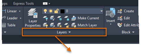

  2. On the ribbon, click the Home tab.
  3. Hold the pointer button over the Layer panels title and drag over the drawing window.
  4. Once over the drawing window, release the pointer button to float the Layers panel.
    Move the pointer cursor over the Layers panel to reposition it using the grip bar or click Return to Panel to return the panel to the ribbon tab which it came from.

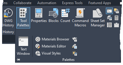

Display and Reposition Palettes
AutoCAD utilizes several modeless palettes to manage layers, external references, sheet sets, and much more. As part of a workspace, you can save the current display state and positions of the palettes you use most frequently. Use the commands located on the Palettes panel of the View tab to toggle the display state of the available palettes and then drag the palette by its title bar to change its position. After setting up the palettes where you want them, save your workspace and upon restoring the workspace all palettes will be displayed based on their saved state.
In this exercise, you'll display the Properties palettes.
  2. On the ribbon, click the View tab.
  3. On the Palettes panel, click Properties.
    The Properties palette and Tool Palettes buttons on the ribbon should now be highlighted on the View tab.

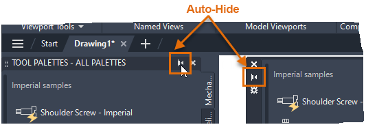

  4. Reposition the two palettes by dragging them using their title bars.
  5. Click Auto-hide on one of the palettes to collapse its display state.
    Moving the cursor over the collapsed palette expands it temporarily.
  6. Save the changes to the HYT Workspace.

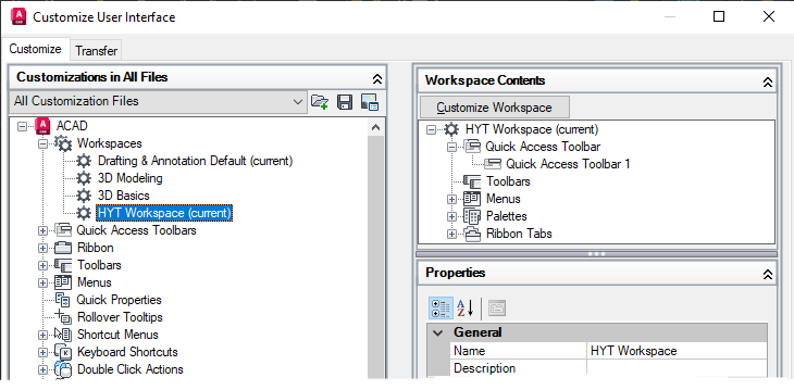

Modify a Workspace with the Customize User Interface (CUI) Editor
The Customize User Interface (CUI) editor provides much greater control over the UI elements that make up a workspace. You can display the CUI editor by doing one of the following:
  • On the ribbon, click Manage tab > Customization panel > User Interface.
  • At the Command prompt, enter cui.
In the CUI Editor, under the Workspaces node, select the workspace you want to modify. Then edit the settings under the Workspace Contents and Properties pane.
For more information on how to customize a workspace with the CUI editor, see About Workspace Customization.
