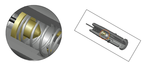

Do you ever feel limited by the rectangular shape of layout viewports? Have you tried creating them in angled, circular or even L shapes?
Here's an example of two layout viewports, one created from a circle and the other from a rotated rectangle, which could be useful for both 2D drawings and 3D models.
While creating rectangular layout viewports is not hard, you've probably encountered situations where a different, nonrectangular shape would have been better, especially when you need an irregular clipping boundary.

With this method, you use the Object option in the MVIEW command to select closed objects such as circles, ellipses, and polylines to convert them into nonrectangular layout viewports.
Note: If you create a polyline, you must use the Close option for the last segment to be able to use it for a nonrectangular viewport.
