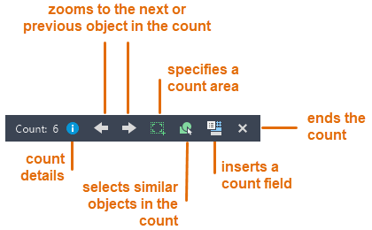

  3. All instances of the specified object are highlighted and the count result is displayed on the Count toolbar. This toolbar provides several commands and options to review and manage the objects in the count.

  • On the Count toolbar, click the Count Details icon.

  3. In the Count toolbar, click Insert Count Field.

  2. In the Count toolbar, click .
All objects in the current count that have the same properties are automatically added to the selection set.

    • In the Count toolbar, click .
    • On the Count palette, click Count in a Specified Area.
    • At the Command prompt, enter countarea.
  2. Specify a rectangular or polygonal selection area, the entire model space, or select a valid object.

  • In the Count toolbar, click the right and left arrows to zoom into the previous or next object in the count.
End the Count
  • In the Count toolbar, click End Count.
