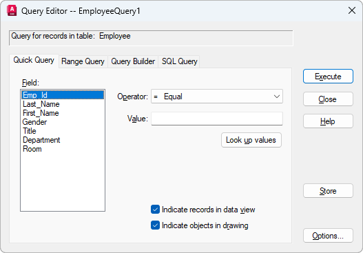

Quick Query Tab (Query Editor)
Develops simple queries based on a single database field, single operator, and single value.
List of Options
The following options are displayed.
Field
Lists the fields from the current database table, from which you can select one to apply to the query.
Operator
Displays a list of available operators that can be applied to the query.
Value
Specifies a value for the field that you are using to construct your query.
Look Up Values
Returns a list of all values for the specified field from the database table in the Column Values dialog box, from which you can select the value you want.
Indicate Records in Data View
Indicates records that match your search criterion in the Data View window.
Indicate Objects in Drawing
Indicates linked objects that match your search criterion in the current drawing.
Execute
Issues the finished query and closes the dialog box.
Close
Closes the dialog box without issuing the query.
Store
Saves the query with the current drawing.
Options
Opens the Data View and Query Options dialog box.
