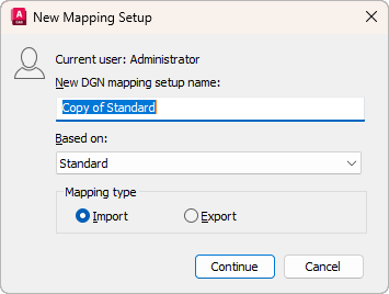

New Mapping Setup Dialog Box
Sets up mapping for the import or export of DGN files.
DGNMAPPING (Command): New
List of Options
The following options are displayed.
Current User
Displays the user’s login name.
New DGN Mapping Setup Name
Specifies the new mapping setup name.
Based On
Sets a mapping setup to use as a basis for the new one. For the new mapping setup, you change only the properties that differ from the properties you start with.
Mapping Type
Specifies what type of mapping setup to create.
Import
Specifies an import mapping type.
Export
Specifies an export mapping type.
Continue button
Opens the Modify DGN Mapping Setup dialog box. Depending on the mapping type selected (Import or Export), the appropriate import/export dialog box is displayed.
