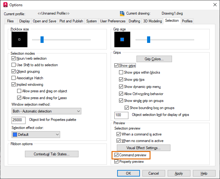

By default, command preview is turned on. Let's make sure it's on.
- Right-click in the drawing area and select Options.
- In the Options dialog box, Selection tab, select Command preview.

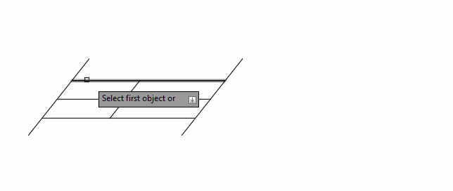

- Hover the cursor near the endpoint of a line as shown.
You'll see a preview of the line extension. The extension of the line is temporary until you select the line.
- Select the horizontal lines and extend to the edges of the two diagonal lines as shown. Do not end the command.

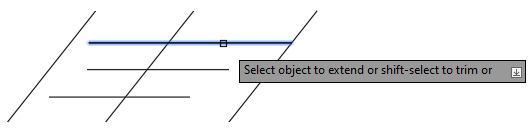

- Now, hold the Shift key to toggle to the Trim mode.
If you've ended the EXTEND command, enter trim at the Command prompt.
- Hover near the endpoints to trim the diagonal line.
A preview of the resulting trim is shown. A cursor badge next to pickbox is also displayed to indicate the trim operation.
Note: For more information, see the Cursor Badges section below. - Select both ends of the diagonal line and press Enter to end the command.

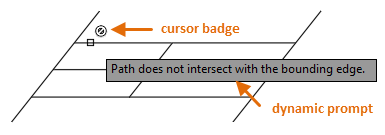

AutoCAD displays error messages or notifications about why you can’t perform certain actions, usually in the command window. Command preview, with cursor badges and dynamic input on, can inform you whether the current operation can be performed and what the outcome might be without first needing to finish the command or expected action.
When dynamic input is on, prompts are displayed in a tooltip near the cursor. As you make changes to your drawing, you can easily see the supported objects, actions, or error messages without shifting your focus between the cursor location and command line.
Cursor Badges

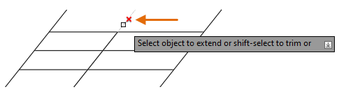

Cursor badges are the little icons that appear near the crosshairs or pickbox cursor. They're dynamic and help identify the editing operation you’re about to perform.
When you hover over an object on a locked layer, a lock badge () is displayed. Unlock the layer to select the object that you want.
The
stop cursor badge () is very handy as this indicates whether an object or action is allowed. This badge makes it easier to know that you're trying to do something that isn't supported; you might be using too large of a radius when creating a fillet or selecting an invalid boundary to trim. There's also no preview shown until you select a supported object or allowed action for the active command.
