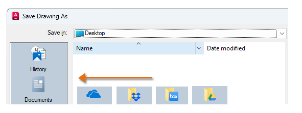

Access From a File Dialog Box
A convenient method for accessing drawings from your cloud account is to add your cloud storage provider to the Places bar. In some cases, this is done automatically. If not, right-click within the Places bar to add your preferred cloud storage provider.
