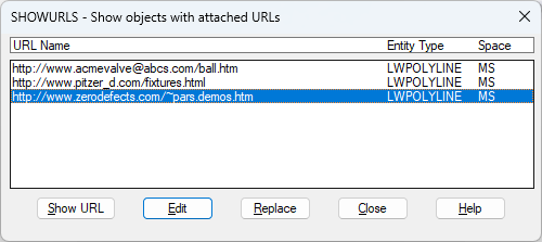

SHOWURLS (Express Tool)
Displays all attached URLs contained in a drawing, and allows them to edited.
Find
Enter SHOWURLS to display the Showurls dialog box. You can click a single URL to display it, or you can click one or more URLs to edit or replace them.
Note: The specified URLs does not need to be currently displayed within the drawing area. If necessary, SHOWURLS will shift the view to include the objects or area.
Dialog Box Options
Show URL Temporarily hides the Showurls dialog box to display the area or objects associated with the URL.
Edit Allows the attached URL to be edited. A common editing operation can be performed on multiple selected URLs.
Replace Allows the attached URLs to be edited using the Find and Replace dialog box.
