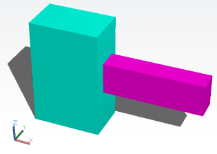

Shadows
Shaded objects in a viewport can display shadows.
  • Ground shadows are shadows that objects cast on the ground.
  • Mapped object shadows or full shadows are shadows cast by objects onto other objects.
The lighting in the viewport must be from user-created lights or the sun for mapped object shadows to be displayed. Where shadows overlap, they appear darker.
Note: To display mapped object shadows or full shadows, hardware acceleration is required.
Displaying shadows can slow performance when viewing a 3D model. You can turn off shadows in the current visual style while you work and turn them back on when you need them.
