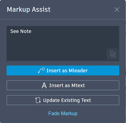

Use Markup Assist To Insert Text
Markup Assist identifies text in the imported markup that can be inserted into the drawing file as multiline text or as a multileader object, or used to append or replace existing text in the drawing.
  1. After importing a markup, with the trace open, turn on TRACEBACK and MARKUPASSISTMODE.
  2. Click the blue highlighted border of an identified text markup. When hovering over an identified markup, you'll see the Markup Assist icon.
    The Markup Assist dialog box opens.
  3. Select one of the following:
    • Insert as Mleader. Starts the MLEADER command and inserts the markup text into the drawing. After inserting as an mleader, the markup switches to faded.
    • Insert as Mtext. Starts the MTEXT command and inserts the markup text into the drawing. After inserting as mtext, the markup switches to faded.
    • Update Existing Text. Use the markup text to append or replace existing drawing text. After appending or replacing text, the markup switches to faded.
    • Fade Markup. Fade the markup so it is less visible on the trace.
    • Copy to Clipboard. Copy the text to the Clipboard.
  4. Often, Markup Assist doesn't perfectly identify the characters in the markup text. This is especially true with hand-written markups. Fortunately, you can edit the text using the Markup Assist dialog box before inserting it. To add more complex changes or formatting changes, it's recommended to copy to the text to Clipboard and edit text outside the Markup Assist dialog box, or insert the text into the drawing, then edit it using the MTEDIT command.

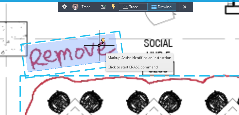

Instruction Text on a Markup
Markup Assist detects certain instructions in markup text that are linked to commands such as "MOVE," "COPY," or "DELETE." When Markup Assist identifies an instruction, you can click that instruction to start the associated command.
