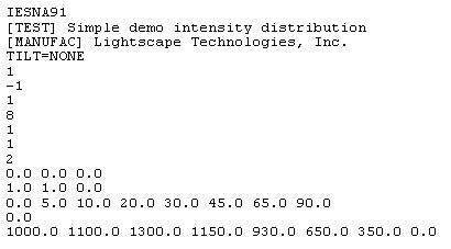

Example of Photometric Data File
The following is an example of a photometric data file.
