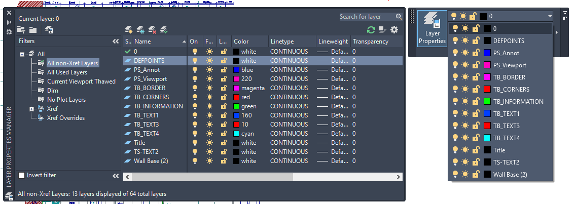

Because layers are central to organizing and controlling properties in drawings, complex drawings might have hundreds of layers. Instead of scrolling through all those layers, did you know that you can reduce the number of layers displayed in the Layer Properties Manager and the Layer drop-down list to just the ones you’re working with?
To specify which layers are listed, you can create layer filters. For example, you can define a layer filter that excludes all layers associated with attached xrefs from those listed in the Layer Properties Manager and the Layer drop-down list.

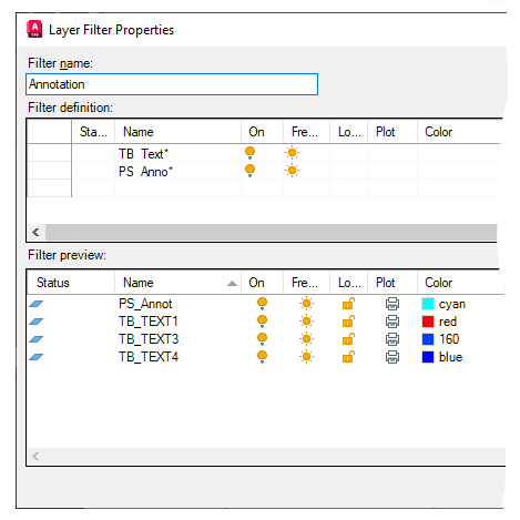

  4. In the Layer Filter Properties dialog box, Filter Name text box, type Annotation or a meaningful name for the new layer filter.
  5. In the Filter Definition grid, specify the property values shown in the following image, or those that relate to your drawing, to control which layers to list when the layer filter is applied.
    Only the layers whose properties match all the property values specified in each row of the Filter Definition grid are included in the resulting layer list when the layer filter is applied. For example, the first row of the Filter Definition grid in the previous image specifies that all layers
    • whose name starts with TB_Text, and
    • are On, and
    • are Thawed will be included in the layer filter.
    The resulting layers from both of the filter definitions in the previous image are combined to determine which layers are shown when the layer filter is applied.
  6. Click OK to define the new layer filter.

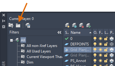

  3. On the Layer Properties Manager, Filters pane, click New Group Filter.

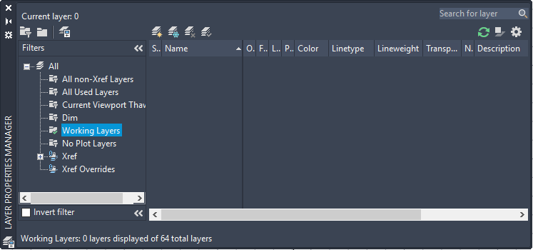

  4. Enter a name for the filter. Since no layers belong to the filter yet, the layer list is empty.

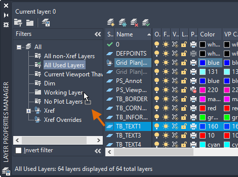

  5. Select another filter such as All Used Layers to display a list of layers that you can add to the group filter.
  6. To add layers to the group filter, drag the layers and drop them on the group filter.
