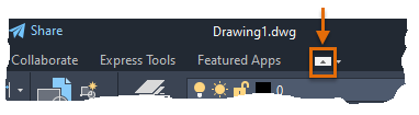

  1. Click the up arrow repeatedly to cycle through several ribbon display modes.

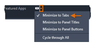

  2. Then, click the down arrow just to the right and choose Minimize to Tabs.

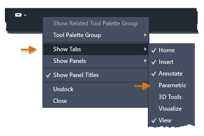

  4. Right-click any ribbon tab to choose which tabs you want to show or hide. In this case, clear Parametric to hide that tab.
    Note: If you want to hide certain panels in the current tab, you can choose the Show Panels option.

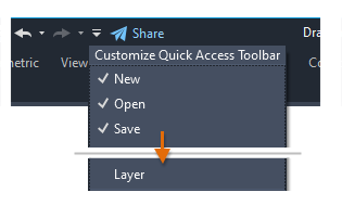

When the ribbon is minimized, access to the tools on the Layers panel is not as convenient. However, you can add the Layer drop-down list to the Quick Access toolbar instead.
  1. On the Quick Access toolbar, click the Customize down arrow and choose Layer.

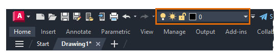

    Here's the result.
  2. Use the same method to add or remove other predefined commands from the Quick Access toolbar.

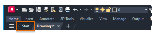

Not everyone uses the Start tab, and you can turn it off if you prefer.
  • To hide the Start tab, enter STARTMODE at the Command prompt and set its value to 0 (off).

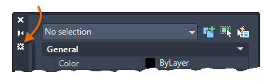

Two of the most commonly used palettes are Properties and Layer Properties Manager. Docking these two palettes together with the Auto-hide option is a tradeoff between losing two slices of the drawing area in exchange for instant roll-over access.
  1. Display the Properties palette.
  2. On its title bar, click the Properties button as shown.
  3. Choose the options indicated:
    Rolling over or off this palette provides fast, temporary access when needed.
  4. Repeat this process for the Layer Properties Manager palette, docking it to the right-side of the application window.

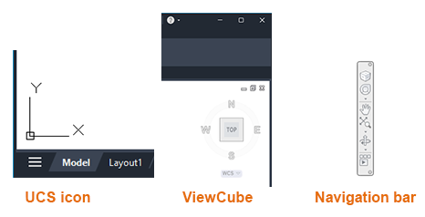

Hide the UCS Icon, the ViewCube, and the Navigation Bar
The user coordinate system is useful in some 2D drawings, and it's essential for 3D modeling. If you don't use the UCS frequently, you can easily hide it. The same is true for the ViewCube control and the Navigation bar.
  • Click the View tab on the ribbon. Then click the UCS Icon, ViewCube, and Navigation Bar controls to toggle their visibility.
