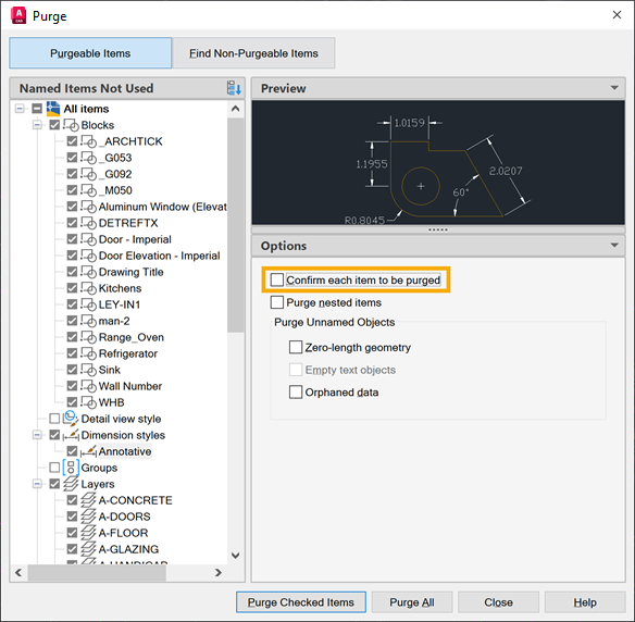

To purge unused items:
- Click
Find

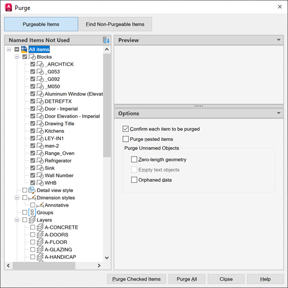

The Purge dialog box opens. There are two viewable lists:
- Purgeable Items. Includes all named items not used
- Find Non-Purgeable Items. Includes all named items in use
Note: If you're using AutoCAD or AutoCAD LT 2019 or earlier, the Purge dialog box has a different appearance, but the features and steps are similar. The main differences are the inclusion of a preview and details about a selected named object in later releases. .

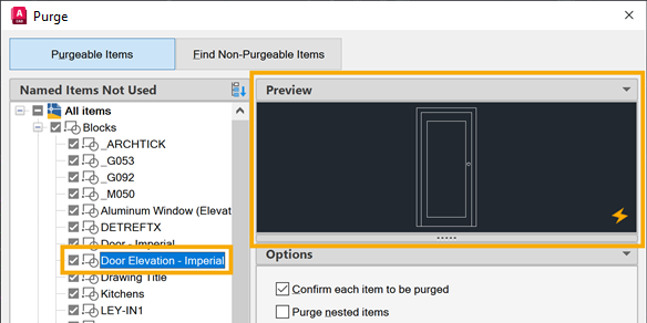

- Browse the items in the Named Items Not Used list. When you select an item, you'll see a preview.
- Click the checkbox next to an item to add or remove it from the list of items you want to purge.
Note: Select or clear the item itself in earlier releases.
- Click Purge Checked Items.
You can also skip the process of selecting the items to purge by selecting Purge All, which purges all unused items.
If you have Confirm Each Item to be Purged selected, you are prompted to confirm each item that's being purged. Clear this option to skip the confirmation step.

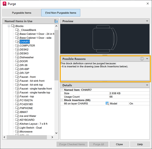

Maybe there's an item you would like to purge, but it's not showing up in the Named Items Not Used list. Use the Find Non-Purgeable Items list to view named items in use in the drawing.
- Click Find .
- Click Find Non-Purgeable Items.
- Browse the items in the Named Items In Use list.
When you select an item, you'll see a preview and a list of possible reasons why the object can't be purged.
In Details, you can see the item size and the number of times it appears in the drawing. To select the items in the drawing, click the Select Objects icon next to the item you want to select in the drawing.
Clicking Select Objects closes the Purge dialog box and selects the objects in the drawing.

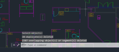

Delete Duplicate Objects using Overkill
Let's try it out. Use one of your own drawings, or use the sample drawing, Floor Plan Sample.DWG, which is shown in the following sections.
- Click Find .
- Enter "all" at the Command prompt to add all objects in the drawing to the selection set.
The Delete Duplicate Objects dialog box opens. For now, let's use the default options.
- Click OK.
This drawing looks the same as it did before. Even though none of the untidiness was visible, 30 duplicate objects and 2,387 overlapping objects and line segments were deleted.

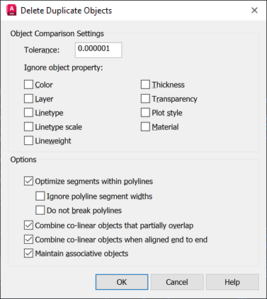

Overkill Options and Settings
Let's try it again, but this time we'll use some of the options in the Delete Duplicate Objects dialog box.
Ignore Object Property
By default, OVERKILL doesn't act on objects that have differentiating properties. For example, if objects are identical but are on a different layer or have a different lineweight, those objects will not be treated as duplicate. However, you can change the settings to ignore certain properties.
In this example, there are three identical line segments, except they are each assigned a different color. Selecting the Color option will remove all duplicate objects.
The following object properties can be ignored during comparison:
- Color
- Layer
- Linetype
- Linetype scale
- Lineweight
- Thickness
- Transparency
- Plot style
- Material
Optimize Segments Within Polylines
In this example, a line is overlapping a polyline. If Optimize Segments within Polylines is selected, using OVERKILL on these objects deletes the line object.
Combine Co-linear Objects When Aligned End to End
With this option selected, line segments that are aligned end to end will be joined to create a single line.
