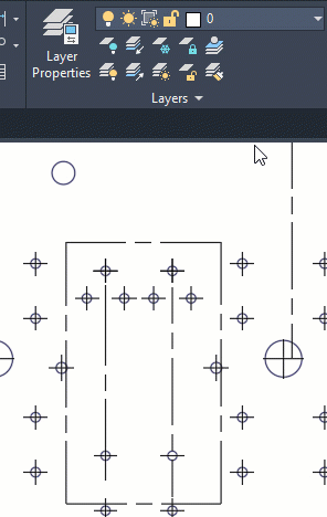

When working on a complex drawing there are times when you might want to turn some layers off, freeze some layers, and change the layer properties of others. If you ever want to return to this set of layers and their properties, using layer states makes it easy. A layer state is like a snapshot of the existing layers and layer settings at the time the layer state is created. A layer state is saved to the drawing and can be restored at any time. You can also export the layer state and import it to another drawing. Other uses for layer states include:

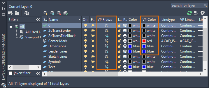

  3. Use the LAYER command to open the Layer Properties Manager. Find
Note: For these exercises we'll use the Layer States Manager, but layer states can also be accessed from the Home tab > Layers Panel. Expand the Layers panel.

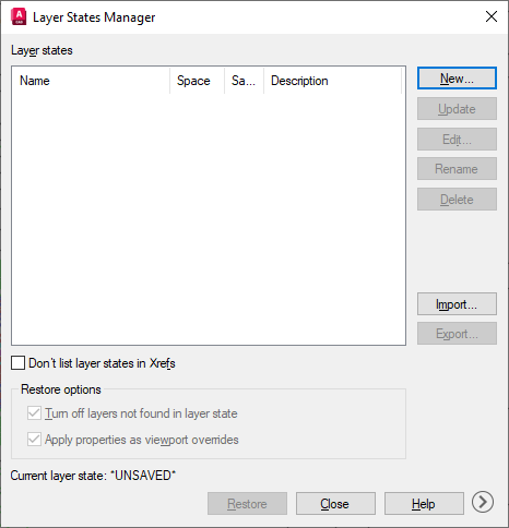

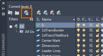

  1. On the Layer Properties Manager, click Layer States Manager.
    The Layer States Manager dialog box opens.

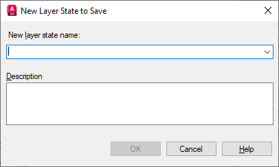

  2. On the Layer States Manager, click New.
  3. Enter a name for the layer state, for example Default, and click OK.

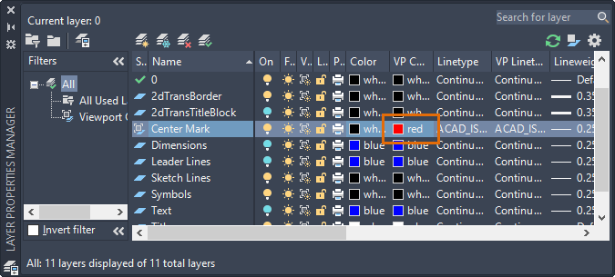

  1. Turn the following layers off: 2dTransTitleBlock, Dimensions, Leader Lines, and Text.
  2. Change the Center Mark layer's color to red. To make sure the color change is for this viewport only, select the color in the VP Color column.

  3. On the Layer Properties Manager, click Layer States Manager.
  4. On the Layer States Manager, click New.
  5. Enter a name for the layer state, for example Annotation Off, click OK and then click Close.

  1. Click Layer States Manager.
  2. Select the Default layer state created earlier and click Restore. The layers are all back on and the Center Mark color is restored.
    Now, let's switch back to the Annotation Off layer state.
  3. Click Layer States Manager.
  4. Select the Annotation Off layer state.
  5. Check Apply Properties as Viewport Overrides since we are working in a layout.
  6. Click Restore.
