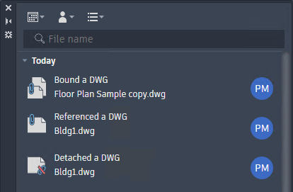

Activity Insights Xref Events
Activity Insights can include when a DWG has been attached as an Xref, detached, and when the Xref is bound.

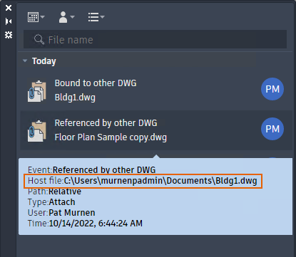

Also included in Activity Insights events is when the drawing has been attached as an Xref to another drawing. The drawing name that references the current drawing appears in the event details.

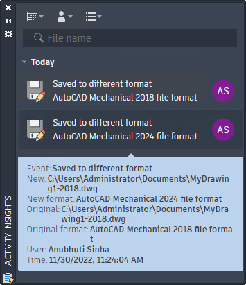

Activity Insights Saved to Different Format Events
