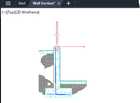

Here's a detail of a retaining wall in model space. You might have created the geometry along with other details on a site plan or you might have inserted it as a block. In any case, you want to display it in a layout viewport at a specific scale. This example uses a standard European scale for standard details. If you want to follow along with one of your own drawings, choose the scales that you typically use instead.

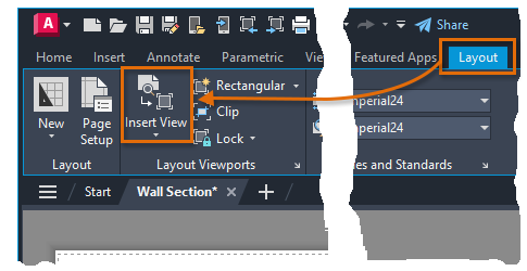

  1. Click the blue contextual Layout tab on the ribbon. Then click Insert View, New View.
    Alternatively, you can enter MVIEW, NEw option at the Command prompt.

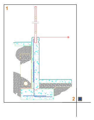

    This operation switches you to model space, which is zoomed to its extents.
  2. Zoom in or out of the detail area as needed.
  3. Click two diagonal points to define the rectangular boundary of the view.
    If the boundary isn't satisfactory, simply click two more points.
  4. Press Enter when you're done. This automatically switches you back to the layout.

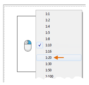

The layout viewport is automatically scaled to fit within the layout, but you might want to specify a different scale.
  1. Before you click to place the layout viewport, right click to display a list of scales and click the scale you want to use.
    The layout viewport resizes automatically to enclose the scaled detail, in this case a commonly used European scale for standard details.

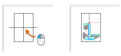

  2. Click the location for the new layout viewport.
  3. Select the new layout viewport (1).
    1. Click one of the four grips on the corners to control the boundaries of the layout viewport.
    2. Click the square grip at the center of the layout viewport to move it to different location.
    3. Click the triangular scale grip to choose a different scale for the layout viewport.
    Note: The display of the layout viewport is automatically locked, preventing you from accidentally changing the scale. To unlock the layout viewport, select it while in paper space and change the Display Locked setting either in the Properties panel or from its shortcut menu.
  4. Drag the Move grip and click a new location. Alternatively, you can enter a distance or an x,y coordinate offset.
